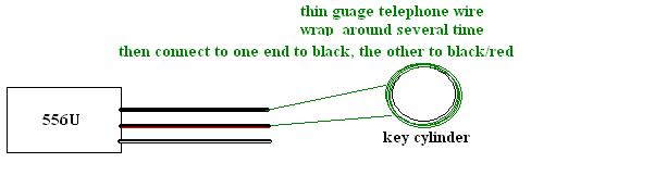

Ok...I cut the ring off of the 556U and now I am lost to which connection i put the RED / BLK & BLACK/ Wire to.
DO I connect them to the Keysense or did I fudge up by cutting the ring off?

its a good thing you cut that ring off, i hate those ring that comes with the 556U, i prefer a think gauge wire (telephone or whatever you have).
556U isnt tight enough for me, i rather wrap my own wire around the key cylinder.
(dont even use DEI bypasses, prefer Trilogix or idatalink)
So, just connect the thin gauge wire to the wires you cut off and wrap it around the key cylinder several times (test how many wraps you need, varies on different car)
I dont have to worry about space when working on 4runners, maybe if you cut off wires your not using and tape everything in one direction then you could cut down on space required.

well the visible wires are BLCK/RED, BLK/WHITE and Black. Should I wrap the BLACK/ red around front of key cynlinder?

posted_image
it should say, wrap the thin wire around the key cylinder several time, then have one end connected to the black, the other end to BLACK/ red.
Dont need to use BLACK/ white

See, I thought I had to have the KEYSENSE wire tapped. BUT now I know. I bet $100 it will work now since I will do that. I have some telephone wire very thin strand. 22-25guage. I HOPE this works.
