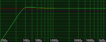

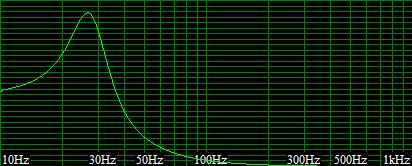

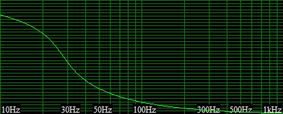

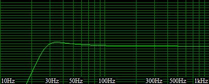

Driver            : Alpine Type R 12"
     Vas : 45.0
     Qts : 0.47
     Fs : 29.00
     SPL : 85.00
Project by        : Owner
Project for       : you
Number of drivers : 1
Box type          : Vented
Box size          : 70.8 l
Tuning frequency : 28.16 Hz
Vent              : 1 vent(s)
     0.351 m length for each
     0.102 m round
             Relative
Freq        Gain        Phase        SPL
[Hz]        [dB]        [deg]        [dB]
20.00        -10.55       254.96       101.44
25.00        -2.70        211.80       109.29
30.00        0.93        163.62       112.92
35.00        1.48        128.78       113.47
40.00        1.28        106.84       113.27
45.00        1.04        91.99        113.03
50.00        0.85        81.12        112.84
55.00        0.70        72.72        112.69
60.00        0.59        65.99        112.58
65.00        0.51        60.45        112.50
70.00        0.44        55.79        112.43
75.00        0.38        51.83        112.37
80.00        0.34        48.40        112.33
85.00        0.30        45.41        112.29
90.00        0.27        42.77        112.26
95.00        0.24        40.43        112.23
100.00       0.22        38.34        112.21
Generated with WinISD[0.44] freeware (C) Juha Hartikainen
You can download your own copy from : http://www.linearteam.org
GAIN
Winisd Alpine Type R Box - Last Post -- posted image.
GROUP DELAY
PHASE PLOT
SPL
This Alpine Type R dual 4 ohm subwoofer will be powered by an Alpine 500 watt amp (@ 2 ohms). I was just wondering if this box would suffice.
Opinions?

that should sound pretty good...I always like type R's in ported enclosures between 2.5 - 3 cu ft

Should I really expect around 110 db's out of that one 12"?

Likely to be more than that due to cabin gain (if you set the system up to achieve such a goal, that is...).

I meant that you were referring to SPL, not SQ, in asking about decibel level.  All the little details of the system work together to maximize SPL.
The modelling program doesn't account for cabin gain and doesn't know what frequency it will boost;  therefore the cabin gain isn't detailed on the SPL chart.  If the program shows 110 db at an attainable power level, the real-life level will surpass that because of the gain in decibels created by the (relatively small) car environment.

Oh okay. Well I was going for more of a sound quality box but would like it to be loud. From the look of those charts do you think it'll sound good?
