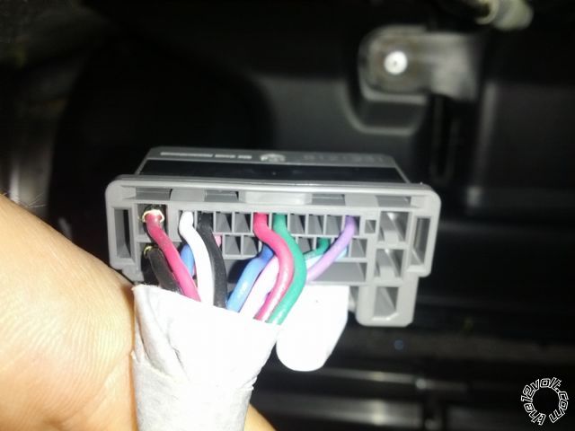

Here is a pic of the other side of the same harness which houses the front speaker wire.
2012 Honda CR-V Audio Wiring Harness - Page 2 - Last Post -- posted image.
Top row (Left to Right)
Red- Constant power
White - Left Front +
Black - Left Front -
Red - Right Front +
Green - Right Front -
Purple - Accessory
Hopefully this helps others looking for this information.

I just wanted to make a post to confirm that elmortero's diagrams are 100% correct.
I just installed an amp and sub using a cross over and stock radio adapter kit.
Everything is working properly and 100% as intended.
Thanks, elmortero!
