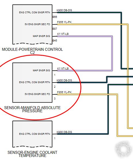

Does anyone have a wiring diagram for the map sensor(which color wire goes where in the wiring plug) for a 2011 Jeep Compass 2.4L engine?

Posted: July 14, 2013 at 2:46 AM / IP Logged
map sensor wiring -- posted image.
Hope this helps.

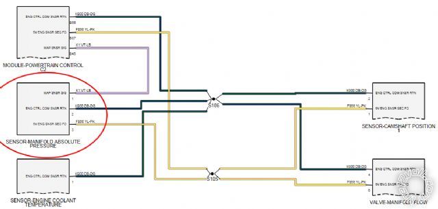

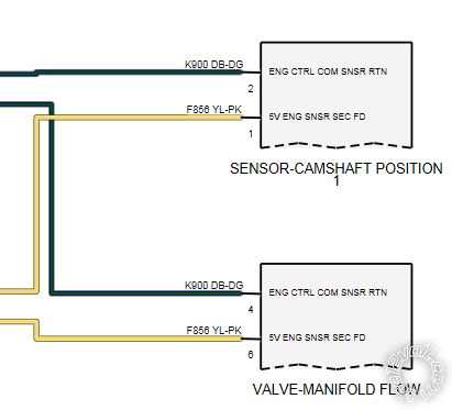

Posted: July 14, 2013 at 2:49 AM / IP Logged
That came out really small. Here is a close up of the left and right sides of the diagram above.
