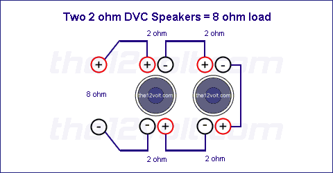

The maths is correct you would be getting about  375W to each sub, you can only wire those subs to be 2 or 8 ohm.  I cudnt see the the power requirments on the spec sheet but im tired so meh, 375W will provide decent respone but it proberly wont be near how far you "COULD" push the subs.  Can sum1 else look at those spec sheets aswell
Option 1 (series/parallel) = 2 ohm load
Voice coils wired in series, speakers wired in parallel
Recommended Amplifier: Stable at 2 or 1 ohm mono
someone double check my math - Last Post -- posted image.
Option 2 (series) = 8 ohm load
All voice coils wired in series
Recommended Amplifier: Stable at 4, 2, or 1 ohm mono

thanks for the response man. and those pics are great.
I wonder if I'd be better off just running one of them at 1 ohm off of this amp and dialing down the gain to less than half so I don't over work the amp.
Would one of these at 800 Watts sound better than two at 375 Watts?
If you put a load on an amplifier that is too low for the amp, no amount of turning the gain or anything else will change the load.  The amp will work at that 1 ohm load and produce current according to the way electrical forces work.  Ohm's Law explains how these forces interact with each other.  You can't change the load with the gain control.
The gain control matches the amplifier output  to the source output so that they both arrive at full power at the same time, which results in the highest signal-to-noise ratio.  That is to say, proper setting of the gain allows for the most power output from the amp and the cleanest possible sound.   It is critical in ensuring that the subwoofers/speakers aren't ruined by receiving clipped signal waves.
We have many good threads on setting gain in this forum's archives (use search), and information on Ohm's Law in the left column.

Exactly correct ^^^^. Running the two subs in a all parallel configuration is going to yield a load beyond what the amp was designed and engineered to operate at. This will result in damage to the amp and quite possibly the sub as well as theoretically this would double the output yet again. IMO, your better idea would be to unload the subs or if they are new, return them and get the dvc 4 ohm version. This would yield a far more desirable result in the longrun for you.
The safe route for you to take in this case if you are not going to change either the amp or sub is the diagram as listed above. While this will not take the drivers to anywhere near their true abilities, it would give the the best of what you do have. Pour time into the box for the system as well. Ensure that it is mounted real good so as not to lose output.

Yes the amp can operate at 1 ohm. However, to operate 1 of his subs at 1 ohm and IF he uses the volume control like I am expecting him to use it, how long will that sub be able to hang in there. Not too long I imagine. Double the amount of power to a sub is not a good idea for a prolonged period of time. His best bet is the two sub approach wired in series / parallel to 2 ohm. Play it safe until the right match of subs / amp can be done.
