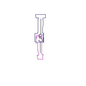

how do you guys package your resistors? - Page 2 - Last Post -- posted image.
I normally do this basically i cut the ends of the resistor short (about 1/2 an inch) then slide it into the narrow end of a pink butt connector then slide the other end into the wide end of a blue butt connector (the blue slides over the pink) this makes a good shell if you will then I can just throw a small piece of wire in each end and do whatever with it (also works on 1 amp diodes). The only drawback is it's not soldered but I've never had a loose resistor come back yet.
