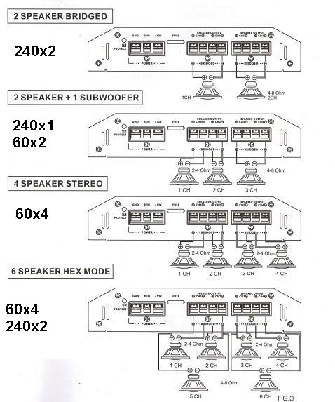

So the subs are @ 8ohm per ch?
If you have them x2 your amp cant run them any lower. So 240w @ 8ohm?????????

*When the amp is bridged 4ch-2ch, minimum impedance is 4ohm/ch, the sub has dual 4 ohm coils... *Iasca ID #10969 IDBL stk-1. Dont tell.   *Everything I get is usually a past model, most still brand new. *Some of your advices I hold in the highest regard, no disrespect. I took out the rocks for a couple days. Had to put em back in. Thanks for trying to talk sense fellas, I'll be getting a new sub soon. *Roxbox 3000G series originated as a temp weight to maintain contour on 1st layer of glass on interior carpets.

The point to the ohms is that you ran 1 sub on this 4ch amp @ 8ohms for near no power. To me a less powered sub should be in a smaller ported box with NO ROCKS

Micheal!...did you do your homework...lets take a look..all ratings here are at 4 ohm. Im using option 1, except both coils are on 1 sub. The amp peaks at 1000w..Option 4 is peak power, the least resistance possible-120x4@2ohm + 240x2@4ohm=1000w +/-....I agree, they outta gimme new stuff to test...except they do it themselves with their current installs. Opiniarian, Memphis as a brand, needs to offer more to the less affluent enthusiasts.
posted_image

I asked you what ohm you were runnin your sub and you DID NOT TELL ME A #
YOU STILL HAVENT
You can only run the sub at 2 or 8 ohm all i ask was which of the 2 are you runnin the sub?
