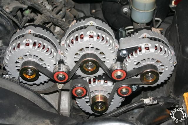

Even though I am not into "sound systems" per se, I have seen multiple alternators - albeit rare.
But that design I mentioned with an additional 250A alternator to supply the audio IMO is quite acceptable - if not recommended (ie, independence; alternator redundancy etc).
A common large alternator size is 250A, hence a nominal 3,450W or 3600W full output @ 13.8V or 14.4V respectively. IE - probably enough to run 2kW output plus the rest of the vehicle (at reasonable RPM).
But 250A is way short of 4kW running at full output.
Now that I see that acetone isn't one of the usual idiots I deal with (nah - he's a special idiot posted_image posted_image - jest kidding - pls bear with me...).... eg - RMS is no issue to him - ie, he seems to naturally assume RMS posted_image (unlike othersposted_image).
So I'll trust his situation and that he needs big Amps.
All I'd caution is the difference between a 4kW "true rated" amp at 4kW output (hence maybe ~5kW input) as opposed half-volume with its ~2.5kW input.
That alone HALVES the alternator's power requirement.
And if voltage is not an issue, then it's more a case of suitable batteries. IE - if output is the same at 12V or 11V etc as it is at 14.4V (and IMO it should be!), then he can do like your cited 10kW single alternator systems.

kenwood_nut wrote:
In over 30 years around car audio, I've NEVER seen anyone with more than ONE alternator! Why would you want to do this? Who gave you the idea? I've seen some $50,000+ systems at some IASCA competitions and still never seen anyone running more than one alternator, even in systems pumping out several thousand watts.
Get a Capacitor or two and you'll be fine.
Having been around it for 30 years, and IASCA competitions i dont know how you have never seen the bronco built buy Garry Biggs and Alma Gates.  It has won many IASCA events and was very popular with a rediculous amount of publicity since one of the builders was a 70 year old grandma.  It had 12 alternators i believe.  multi alternators has been done, many times.  I have never done it myself so i cannot offer any advice, but here is some proof for you that it can be done.
posted_image
If your cousin is such a good installer, and he will install anything for a 6 pack; why are you talking to me?

And that truck has a hell of a lot more underhood room than a Golf, so in the real world.
