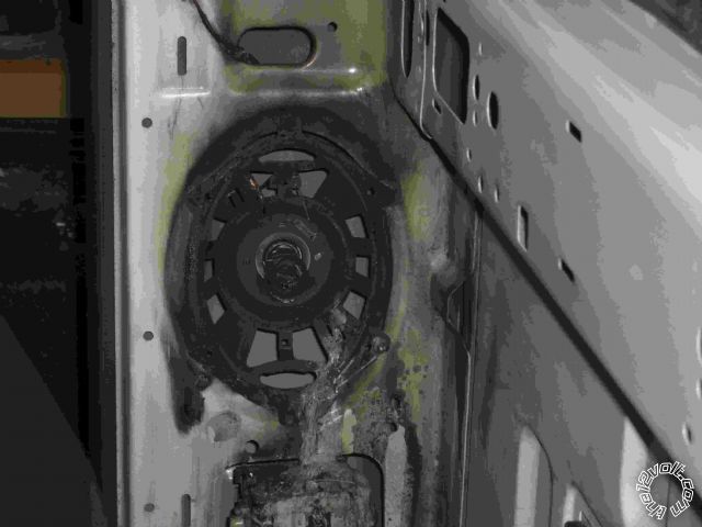

This is not a horn, but it closely resembles what can happen.
Posted By: howie ll
Date Posted: August 15, 2011 at 3:44 AM
Craig, though I use the live and ground leads sometimes to test which speaker and and it's phasing rather than a meter or an AA battery don't you think this was taking it too far?
------------- Amateurs assume, don't test and have problems; pros test first. I am not a free install service.

Posted By: i am an idiot
Date Posted: August 15, 2011 at 5:32 AM
Howie, we really have no idea how this happened. He claims that he put the amp in and the amp made a strange noise so he removed the power fuse from the amp. Claims this happened overnight when there was not even a fuse in the amp. Door speaker on same channel was damaged as well, it just did not catch fire. He claims the rear fire put itself out.
