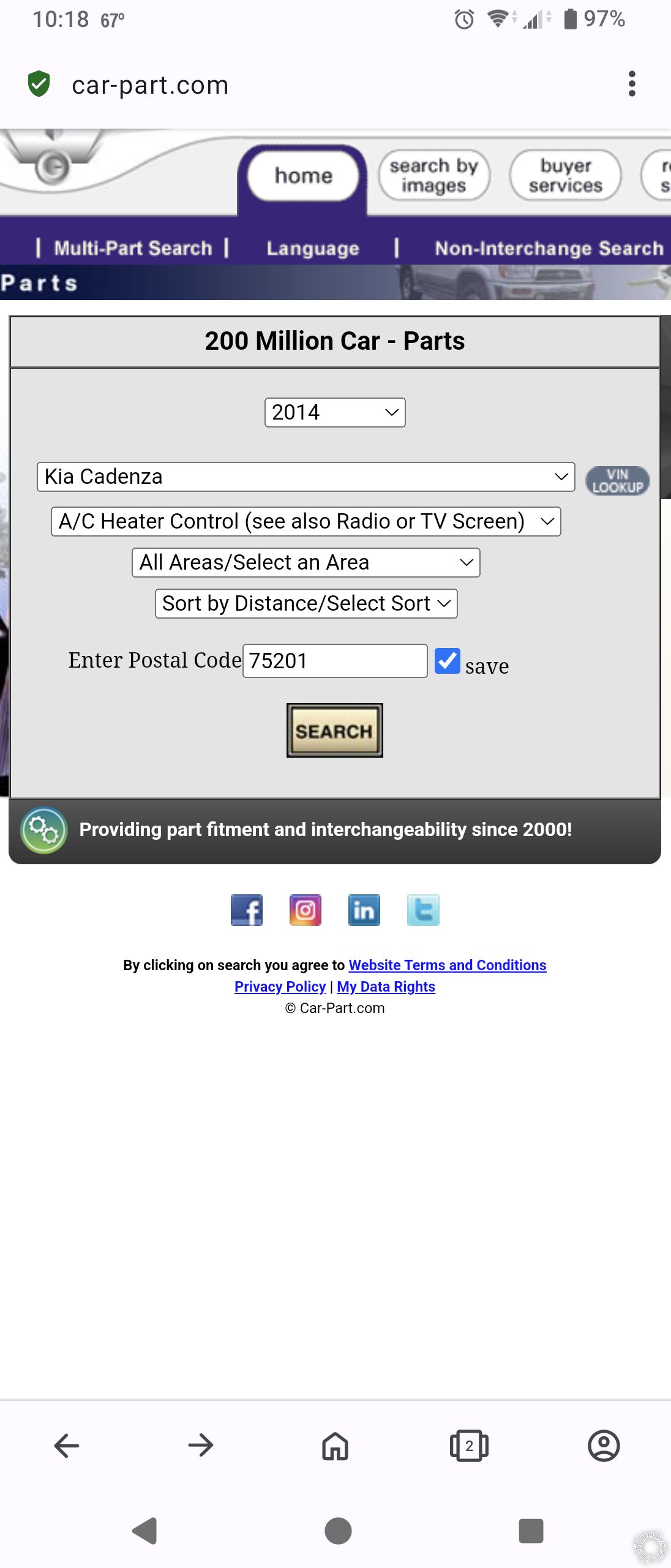

Posted By: lee.lopez
Date Posted: November 02, 2024 at 10:20 AM
Lookup here first to narrow your search: https://car-part.com/
