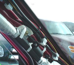

In general yes they seem to be making them fit tight as ever mainly in cars with air bags running near them. I agreee with wanting to make sure the wires don't interfere.. Nobody wants to be liable for someone getting injured because our carelessly run tv wires or something didn't let the airbag deploy correctly. I always try and find whatever way the factory wires are run and piggyback them..
posted_image
Just recently had fun trying to get one off of a Navigator.. As if the two bolts weren't enough they had to add a push clip way down where you can't get any leverage to pop it. Could've been worse I guess.. Oh and the pic above is from a Toyota Sienna by the way.
