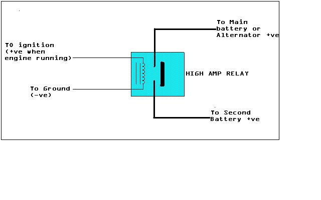

There really isn't much installing a second battery. Most probably you are installing a battery not identical to the original one in the vehicle. Whether the batteries are identical or not, adding an isolator just makes sure the two batteries don't "compete" against each other by draining off the one with more charge when your engine is not running (when your alternator is not charging). An isolator is just a high amp relay switch. Generally I've heard of (and myself used) a PAC200 isolator, which is a 200Amp relay. Just by looking at it, one can see 2 small connectors and 2 big connectors. The big ones connect the source or main battery's positive or the alternator's +ve to the extra battery's +ve. The relay (as any other relay), has 2 connectors, one of which connects to the ground(-ve) and the other to a +ve that is true ignition, meaning no voltage when the vehicle is not running.
Maybe a simple picture will help.. Let me draw up one. and post it in a few minutes.

posted_image
The new battery's -ve goes to ground.. just in case someone has a question. Sorry about a not so great picture but just to show how easy the connections are.    Also I made the switch's connectors thicker and the coil with thin lines.
Mark
