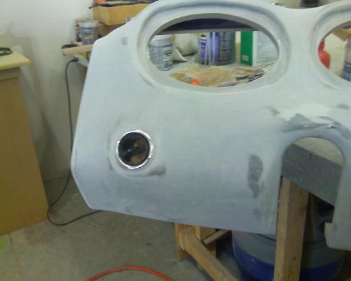

Date Posted: July 30, 2009 at 7:37 PM
posted_image
here we go guys. first step take out the old dash!! duh. keep it around so you can trace the part that come's in contact with the dash. makes life so much easier. now set that in place. no make your end caps. if your useing the factory door panel trace out the side of the dash so have a perfect line up to the factory doors. this makes it look that much better. in this picture i've already made those Gay 6x9 rings flush mounted of course. once you have your end caps cut and routered out get in the ride and close the door, screw these peices to the inside of the truck and make sure they line up with the door when it's closed. if you lok close i took a peice of 1/4 inch mdf to space it away from the door so it is not touching the door but comes very close. you do not want it to touch. once your all screwed in attach your top plate to your side plates. as in this picture.
posted_image
this picture show's how close my end caps are,
posted_image
This should get you going more to come tommorrow!

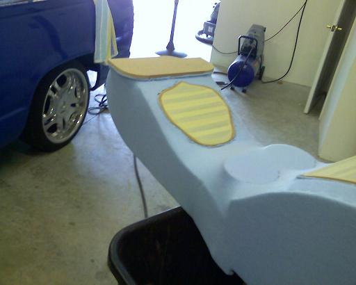

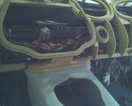

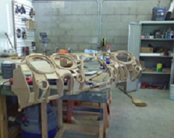

Posted By: biggidaman
Date Posted: August 04, 2009 at 11:45 PM
posted_image
ok in this picture i've alreadystared the console and added most of my bracing, these braces alow me to get an idea of how the dash shape is going to look before i even wrap it in fleece.
posted_image
notice where the console meets the dash, i've made to pieces exactly the same size and screwed thm together. top one is set in to place attached to the dash and the bottom to the console this will allow me to have a perfect match up between the console and dash in the end. you'll see more of this as we go on. the big opening in the middle is routered out to accecpt and peice of plexi that will be back lit. and also house the digital gauges nd double din radio.
Biggi Kustumz home base operation since 1998. car audio should be fun not work!!!!

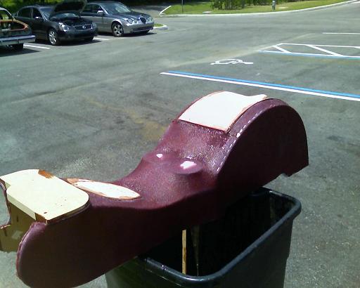

Date Posted: August 05, 2009 at 7:07 PM
posted_imageposted_imageposted_imageposted_image
here are a few pictures of the console. the console has a smaller version of the shape thats in the dash and will also be a back lit plaxi glass peice but this peice will house the switches for the head lights and the neon's in and out of the truck. i'm putting the A/C controls in the glove box in the console. just to make things look a little cleaner in the dash. in this picture you can see the rings i built for the A/C vents also. give me some feed back here and let me know what you think. More to come very soon. this dash and console are already done i have just been posting pictures when i have time. this whole process took me about a week to complete minus paint and installing it of course.

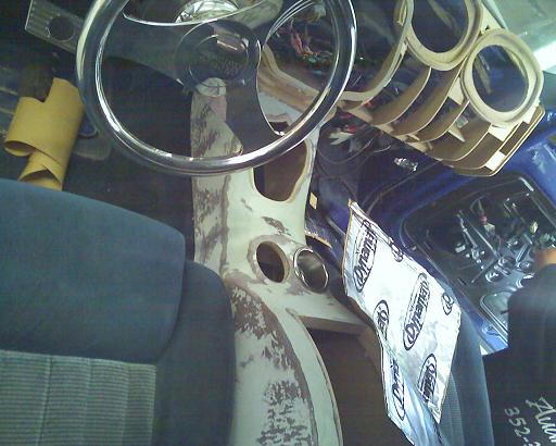

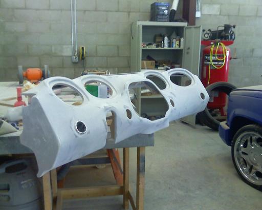

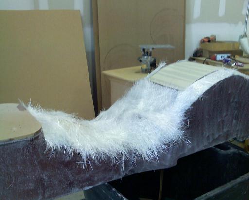

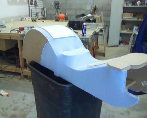

Date Posted: August 06, 2009 at 9:30 PM
posted_image
this is the way the finsished mocked up dash should look when it's taken out ,
if you do this right you shouldn't have to keep taaking the dash in and out to test
fit i test fit this dash one time before glassing and one time after, it fit perfect both times.
posted_image
this is after fleece, two layers of 2oz matting body work
and first coat of primer. check out that AC vent test fit
posted_image
notice how i did the steering collum. when i did the second test fit i went ahead and made
a glass peice to cover that open area under the collum.
6x9's how Gay!!! lol not my dash can't see it from my house. lol the dash hasn't come back from paint yet.
this is why i like painting all my own work, now i have to put my whole prodject on hold waiting on the customers painter.
and of course it's probaly going to come back screred up. but what do you do the customer's always right. ,ore to come. wait till you see the plaxi pieces.
plain and simple but pretty cool none the less.
