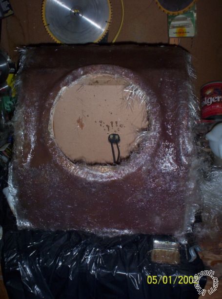

Posted By: pcana11
Date Posted: September 19, 2009 at 4:36 PM
posted_image
Posted By: pcana11
Date Posted: September 21, 2009 at 7:32 PM
posted_image
This is the semi dry version, last layer of mat, start the whole bondo process tomorrow. do i just sand down the fiberglass and get all the imperfections out before body filler?
Posted By: ianarian
Date Posted: September 21, 2009 at 7:46 PM
Yes sand of all peaks and pieces that stick out before body filler.

Posted By: pcana11
Date Posted: September 21, 2009 at 7:52 PM
alright, thanks ianarian, and when i mix the filler, should i mix it with fiberglass resin also or just apply it by itself
Posted By: briankmizell
Date Posted: December 29, 2009 at 11:44 PM
Most people mix resin with the filler so it will flow out easier.
It tends to get quite messy doing it that way so you can do it with out if you like. Just make sure that when you apply the filler you wipe it donw nice and firm with the spreader so it wll adhear good.
I cant give you an exact measure on how much resin to put, but my guess would be 3 parts filler 1 part resin.
