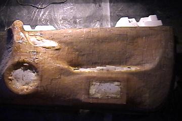

step 2
add fiberglass mat, and grind down high spots with dremal cutter wheel and mouse sander with 60grit and 80 grit paper
posted_image

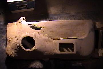

step 3 add body filler
posted_image

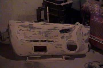

step 4: sand, oh and sand again, and a few more times.
posted_image
last minute i decided to mold in the arm rest, and the speaker grills using kitty hair fiberglass and body filler
if i forgot anything, let me know,  justin
