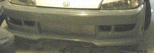

Posted By: drunkenbreaker
Date Posted: June 13, 2004 at 1:59 AM
I found this pic of an 89 celica.
posted_image
That white line I drew is the end of the bumper.  It has a very large front fender.  If this is, in fact, the right car then I suggest starting with a 88-91 honda civic body kit.  Fortunately you can find those kits cheap on ebay or on sensemotorsports.  You want a kit like that because there is no definition on the top of the bumper where it meets the grill and headlights.  It is the same on the old civics.  I would fit the bumper and then cut the fender to fit the bumper.  I wouldn't try to modify the bumper to fit the fender.
posted_image
see how flat the top is.  This is the Black Widow kit for an 88 civic.  I think that would be the best fit.
