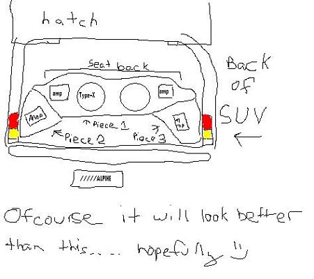

Like, i wan't to be able to take it out in a hour or 2.  I'll make the sub box out of mdf, then make a fiberglass cover to make it look like a fiberglass enclosure, then a panel on each side of the box running to the back of the truck on each side.
I'll try to draw up a pic of what i mean.

Cool, thanks guy!    Anywho, as you can see i have 3 pieces their, what i want to do is be able to remove parts 2 and 3 , then get to the box part 1, and remove that too.
I was thinking bolts through the floor for the main box ( part 1), then some kind of interlocking idea so i can slide parts 2 and 3 to fit snug up against the main box.
I need all this to be removable for when my bro takes my truck and fills it full of his school supplys and moves outa town for the school year, , i get the truck back the next week obvioulsy.    Also, in the winter i don't like a intesnse system, , so this may be a warm weather only thing.
