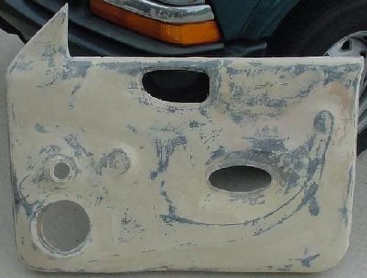

allright ppl i have a few things to say... "F" spray adhesive!!!! completely screwed me over and set me days back... and second... now that i have gotten going again... id like to say that i hate body work... ha... but thank god for orbital sanders... they are awesome... i would definetly have to say that if i were ever stranded on a deserted island as long as you left me with my sander id be happy... no anyways.. yeah some problems with some spray adhesive set me back a little and then the rain did not help me out at all... it has raind both of these past weekends so i havent been able to get much done.  right now im gettin close to done i think... my driver side door is all bondo'ed glazed and ready for primer but i still have some work on the passenger side... it was affected by the spray more... on top of everything id also like to mention that my psu in my machine went out a couple days back... what luck... well non the less here is a pic of one of my doors as of last night... its comin along... slowly but still...
well we'll see what happens today....
posted_image
posted_image
-J

Hey folks i promise i didnt give up on the project... ive just been to busy to go and buy a PSU for my machine at home... back to college and all.... so yes i do have pics here they are... curves are suttle, but they are there.. really kinda what i was goin for seeing as i want the truck to look completely smooth on the inside.
I also started my headliner this past weekend.  i took a break from workin on friday though.. i wish i hadnt.. otherwise id be putting paint on it allready.  but here are the pics of that so far.
oh hey nuenoter.. i had kinda thought of put some neons in it somehow... but really didnt know how i wanted to incorporate them.. now afterwards thinkin about i realize what i should have done... too lat though.. DANG!.
well anyways here are the pics.. ill try and get the finished headliner up as soon as it is ready...
-J
posted_image  posted_image
posted_image
Fiberglass Resin
posted_image
Body Filler
posted_image
Bondo Sanded Down then Oval screwed down and edges bondo'd over.
thats it.
