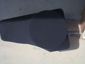

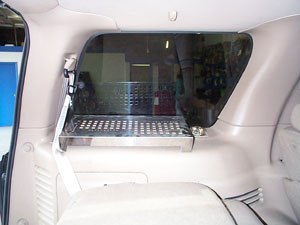

I got some pictures of a box I built for my wifes 97 Expo. I'll e-mail the to you if ya like!
Or try to post them here.
Posted By: spl-Hz
Date Posted: November 23, 2004 at 4:46 PM
posted_image
Heres 1 pic trying to upload more having problems with size
Posted By: spl-Hz
Date Posted: November 23, 2004 at 4:51 PM
Dont ask me what happened!!

Nice... Is that the sub enclosure for the rear? How long did it take and does it get in the way of anything?
Wildkind Concepts
Posted By: spl-Hz
Date Posted: November 23, 2004 at 6:25 PM

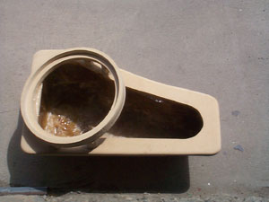

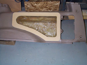

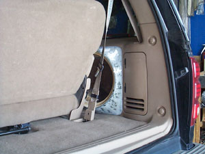

Yes it goes in the rear right panel in front of the jack storage. After modifiying the old storage pocket.
I have the other pictures to show how it was done but like i said I cant figure out how to post them correctly.
Im better at custom installation then on the computer I guess. Thank's for the fix Jeff.

Posted By: spl-Hz
Date Posted: November 23, 2004 at 6:28 PM
Alright give me a minute

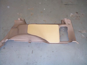

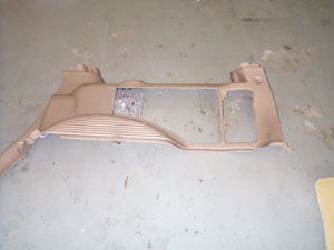

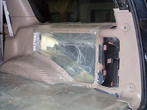

Posted By: spl-Hz
Date Posted: November 23, 2004 at 6:46 PM
posted_image
posted_image
posted_image
posted_image
posted_image
posted_image
posted_image
posted_image
Finally figured it out. Hope you like them

Power Acoustik Fubr-12 running off an Xtant 1001dx. Final enclosure will be vinyl color match.
This box took approx 20 hrs Also this was my first fiberglass enclosure.

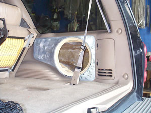

How are you going to secure it in place?
Posted By: spl-Hz
Date Posted: November 24, 2004 at 10:22 AM
I'm going to bolt it down from inside the enclosure to the body of the truck

That belt clip won't rattle against the seat will it?
That looks really good. How many layers did you use? What ounce mat did you go with?
Please post pics of the final results!
DXAV
Posted By: spl-Hz
Date Posted: November 24, 2004 at 5:26 PM
Haven't heard the belt clip rattle yet. Backside layers 14 with 3/4 oz chop mat.
Front face 20 layers with 1oz chop mat. the box sounds excellent and hope to have the vinyl on in a week or two.

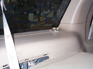

Below are the pic's of the left side of the expedition. Digital top for the cap in the cup holder next to the Xtant 1001dx
Capacitor is mounted in the compartment with the rear air blower motor.
