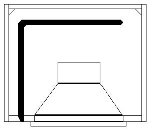

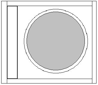

Posted By: spitra_01
Date Posted: December 08, 2004 at 11:20 PM
have you try a vented style box
example:
top view
[IMG]uploads/top.JPG[/IMG]
front view
[IMG]uploads/front.JPG[/IMG]

Posted By: JosefSchmidt
Date Posted: December 09, 2004 at 5:49 PM
thats actually identical to the box I tried that sounded wonderful, and I've had it in that box before in a 300ZX but I bought this BMW and the box is too tall to fit in the trunk.
