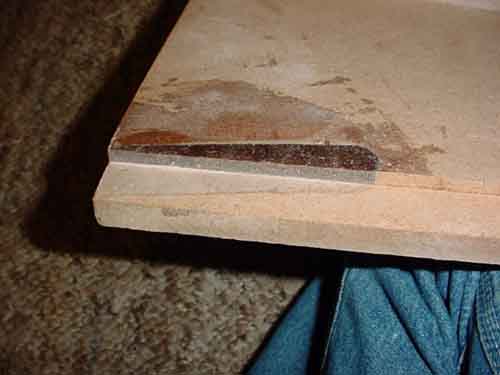

Here is what I did.  I mixed half a cut of resin and MEKP up.  Then I slopped a little bit in the slot to line it with pure resin.  Then I mixed a lot of MDF saw dust/powder into the resin in the cup.  After that I mixed it well and pasted that stuff in there.  Applied heat, waited for it to gel, then took a razor blade and cut it flush.  Then heated it till done.  Here is a pic of what it looks like now.  Should be plenty strong.

Looks good!  That definitely should do the trick.

Here I have routed the edge how it should have been in the first place.  The resin/MDF mix routed well, but it severly dulled the carbide edges on the router bit.  Here is a pic of the routed edge.
