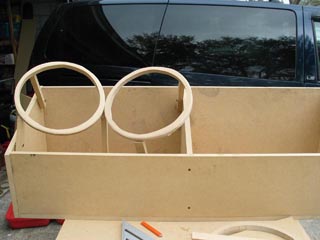

Date Posted: January 22, 2005 at 8:27 PM
posted_image
ok this is what we've got done so far....tomorrow the fleece.
the rings were a B@#$% went through two dremil bits. then had to finish with the jigsaw.

Used the divider to strentghen the back side of the box.

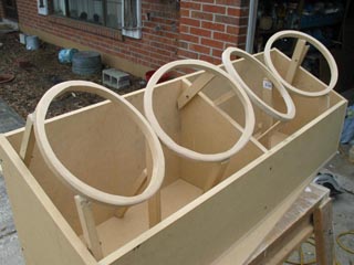

all the rings in place.
posted_image

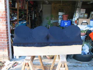

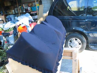

this morning we streched the fleese....it was 30 deg's in sunny florida this morning....not as cold as you guys up north but for here it's butcold!
posted_image
this is another view the staples were used to keep the shape of the rings.....do i have to remove them?
posted_image

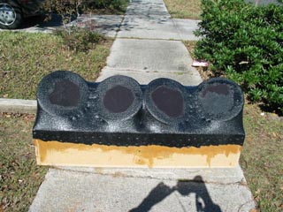

here it is with the first three coats of resin applied,  you may ask why three?....well the first and second were applied with only half the needed hardner, the cold got to me and i miss calculated, once i warmed up i realized my error and we mixed up another batch with just a wee bit more hardener and the set in the sun to increase the heat and it hardened in a couple of hours.......man is it stiff...the glass not me. will let it set till next weekend and then we will start the layers of fiberglass. any comments or sugestions are appreciated.
