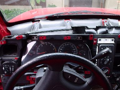

Picture of the top left of the dash with the plastic dash already removed.

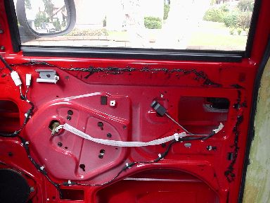

Picture of the right door with the panel removed and ready for Dynamat Extreme.

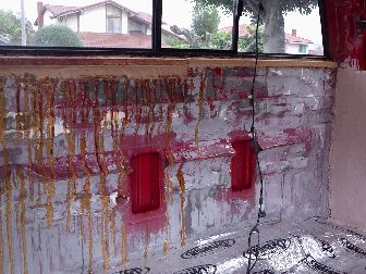

Picture of the back right corner.  I made a flat wall out of MDF, Duraglass, and Rage Gold so it was smooth and flat.  I will be carpeting the back and wanted to have flat walls to carpet.  I still have more Dynamat to lay which I'll do this weekend since it's supposed to rain tomorrow.

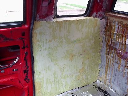

Picture of the back wall with the seat and everything else removed.  I glued two MDF slots under the window to be the top part of the frame for the sub box/amp rack I will be building.

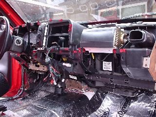

Picture of the whole dash with the covers removed again.  You can see the airbag on the right side.

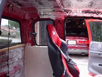

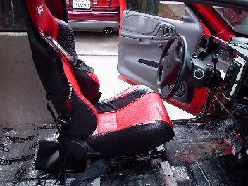

Picture of the right wall.  I still have to sand it down so I can carpet it.  You can also see the top of my racing seat.  The other chair I took out while I did work.  They were both custom welded to the OEM seat brackets so they would fit in the truck.  They still slide back and forth and slant backwards too.  You can see I'm laying Dynamat everywhere, even the ceiling.  About $300+ of noiseproofing even after buying it on Ebay for half price.

Picture of the whole chair and steering wheel.  I still have to use a whole bulk pack box of Dynamat Extreme.

Now the work is really starting.  I used a Dremel with a $15 diamond cutting blame, and a jigsaw, to start cutting off about 1.5 inches of plastic from the top of the dash that hangs over where the gauges are.  I unscrewed the headlight/foglight switch and it's hanging down so I don't cut it.  I also did not want to cut the clear plastic gauge cover because if I were to damage it, I'm sure Dodge would charge me my first born child to buy a new one!
You can see the top where I'm cutting it off.  It only took a few minutes with the dremel and jigsaw.
Picture of the work done.  The gauges are now much more visible.  You can see the air conditioning switch panel hanging off the dash.  The top of the dash is now much more flat.  I plan to make an MDF frame like Alpine did for their show car and make a fiberglass dash.  It's supposed to rain tomorrow, so I'll have to finish the Dynamat and vacuum on Saturday.  Then I can get started on my new dash.  I have an 8" monitor, PS2, and Alpine head unti to fit in there too.  Much much more to come!

I don't follow why you're gluing wood to the interior... don't you want to be able to take the box/amp rack out to finish all the fiberglass etc with paint or carpet?

Sorry Kosoku, I guess I didn't explain that part.  I will be making an MDF frame for the dash like Alpine did.  Then I will probably tape the wood with painters tape and cover it with tin foil too and put a mold release on it.  Then I will wrap the whole thing in fleece and staple it to the wood, through the foil and tape.  So the fleece will stap tight on the MDF, but when I cover it with resin, it won't seep into the MDF and make a bond with it.  Then when the dash hardens, I will be able to pop it off pretty easily and take it out for finishing and painting.  I think I will tray to lay a few layers of glass and coat it with Marglass like Alpine did before I take it out though.  That way it won't warp when I pull it out.  I will make sure to form the piece in a way that I can still pull the whole thing out with help from a friend when it's ready.  My steering wheel can bend way down and will not get in the way.  Also, I will be making a second piece that will be for the front and bottom part of the dash.  I will do that piece in the same way.  The Top will be painted red when I'm done and the bottom will be black.  I will probably also do a custom center console for my switches and controls and that will also be painted red.
