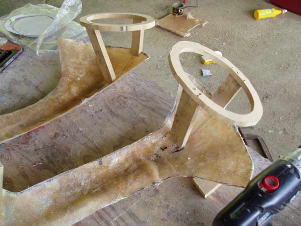

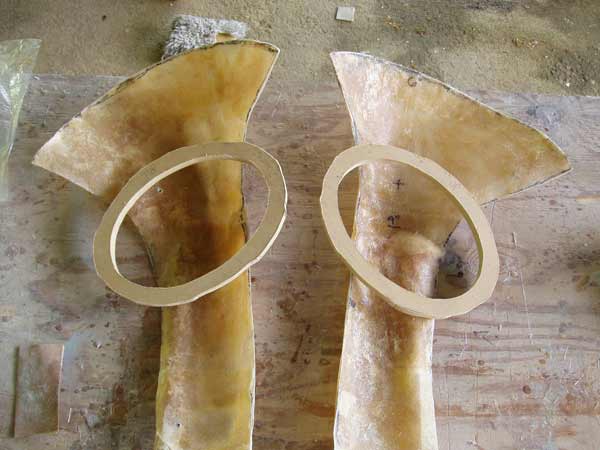

I'm making this box for my Bronco.  I made it following the specification for a good SPL (3.2 cuft).  There will be other projects like the amp rack and a center console.
Let me know your opinions.
posted_image
After taking out the seats and carpet. A good mess left.
posted_image
posted_image
posted_image
The form of the box with the back hole of the trunk shape
posted_image
posted_image
As you can see no router were used,  I used a jigsaw (real pain ine the ass)
posted_image

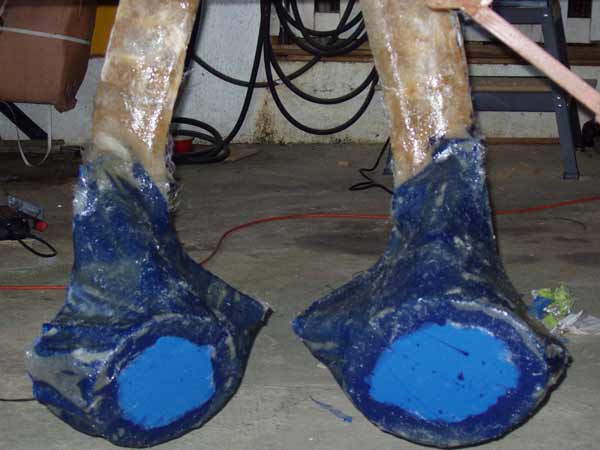

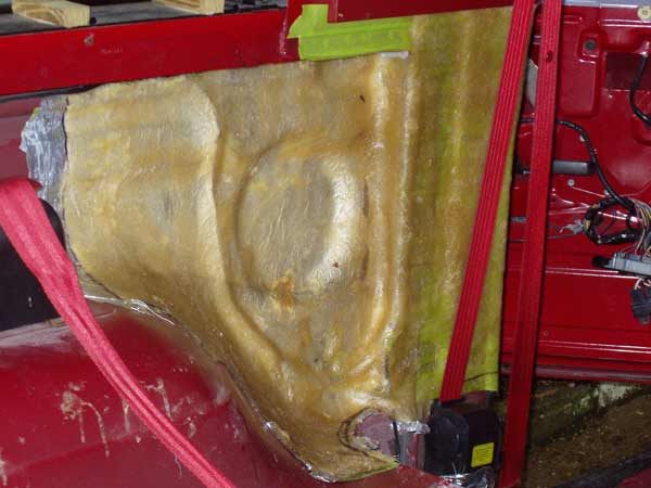

The fleece part.
posted_image
posted_image
Several layers of FG (will be 6).
posted_image
The upper port
posted_image
posted_image
After sanding and verifing the sub.
posted_image
The skull for the lower port
posted_image

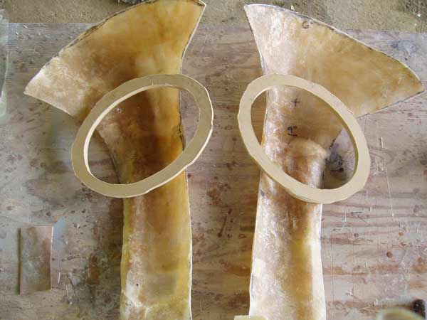

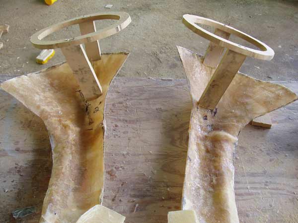

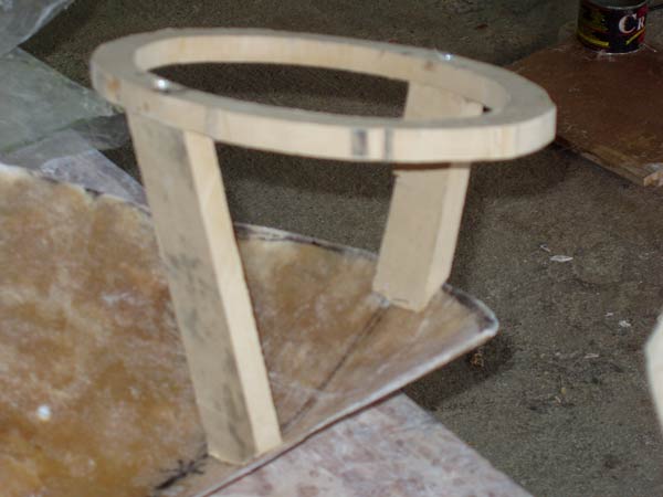

posted_image
posted_image

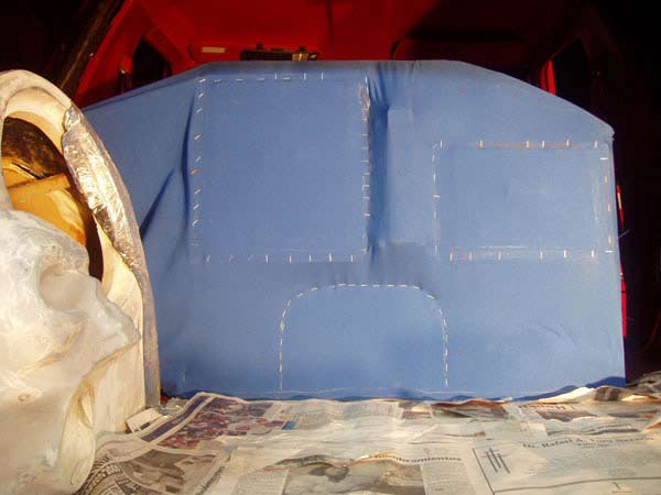

I made the mold of the back and checked if fit.
posted_image
posted_image
I will update the work as soon I advance.  Now comes the bondo and the sanding.

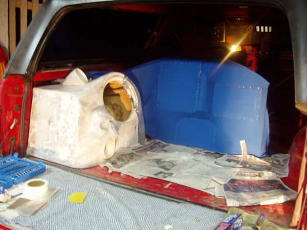

Date Posted: July 05, 2005 at 11:19 AM

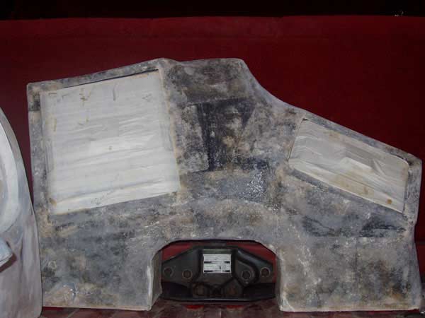

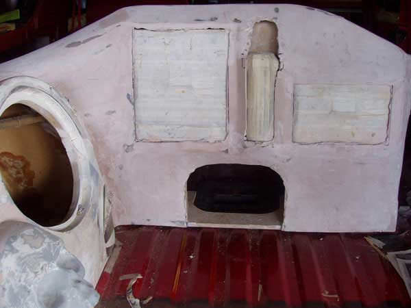

Here are the promised pictures. I just need to sand the box a little more to then paint it color red (as interiors)
I began with the amp rack.          Enjoy and post comments and suggestions!! Thanks.
posted_image
posted_image
posted_image
posted_image
posted_image

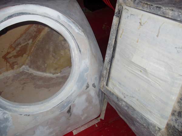

I find some hole so decided to continue sand 'till I be able to see myself in the box (mirror) :)
posted_image
Here you can watch that I missed by 1 1/2" the desired angle (I fixed adding little pieces, ha, ha)
posted_image
posted_image
posted_image
posted_image
posted_image

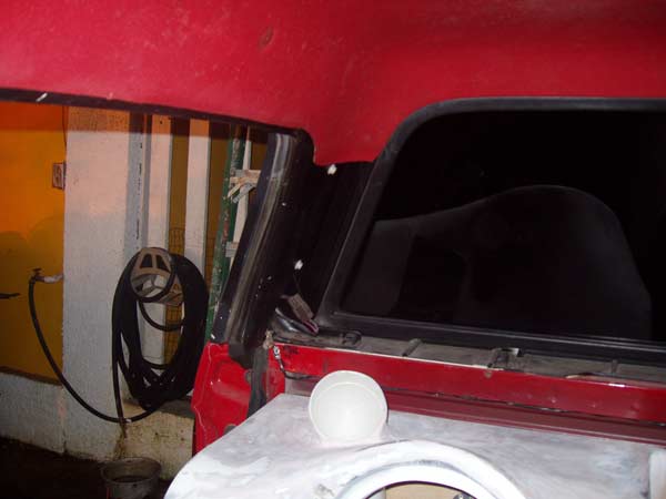

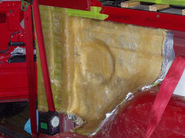

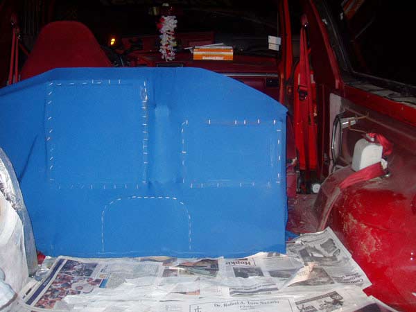

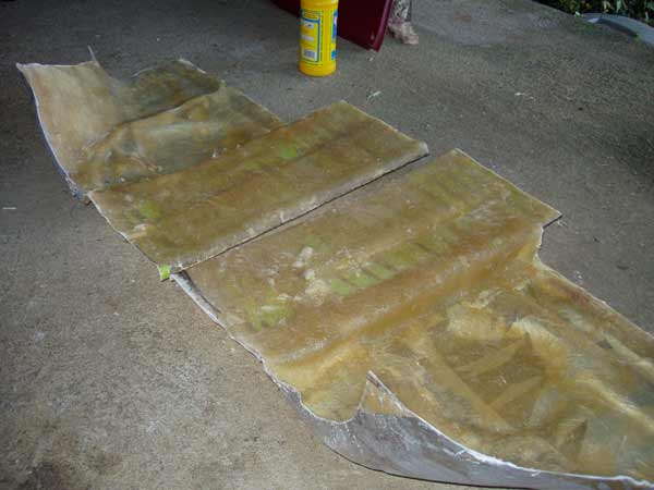

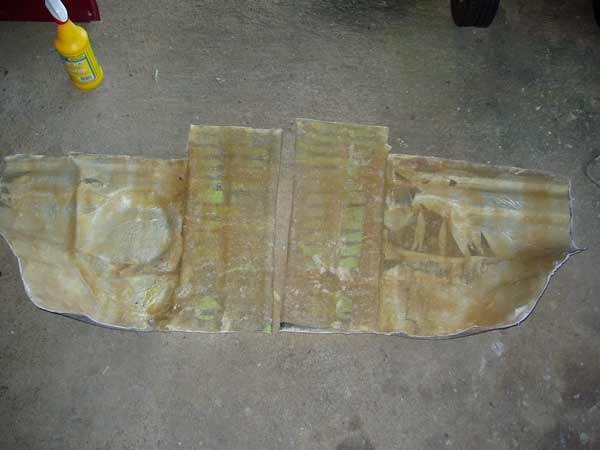

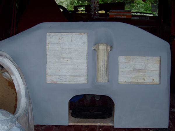

Been busy last couple of days but here is my progress.  I decided to change the amp rack to a more simmetrical one.  Place your comments.  Thanks!
posted_image
posted_image
posted_image
posted_image
posted_image
posted_image
posted_image
posted_image
posted_image
posted_image
posted_image
posted_image
posted_image
posted_image
posted_image
posted_image
Posted By: HottAccord
Date Posted: July 26, 2005 at 3:28 PM
Wow, thats quite a bit of work you're doin now. Lookin forward to more progress, nice job!
Im a fiberglass whore!!
Posted By: stuntjester1
Date Posted: July 26, 2005 at 4:02 PM
looking sweet, keep the pics coming. Going to be bad ass in paint!
Posted By: broncoman
Date Posted: July 26, 2005 at 4:29 PM
I'll be working with the sanding and finishing details (corners, frames, etc) this weekend.  Looking forward to complete asap for painting with interior match.

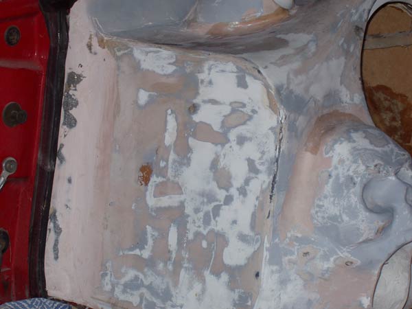

Date Posted: August 02, 2005 at 9:15 AM

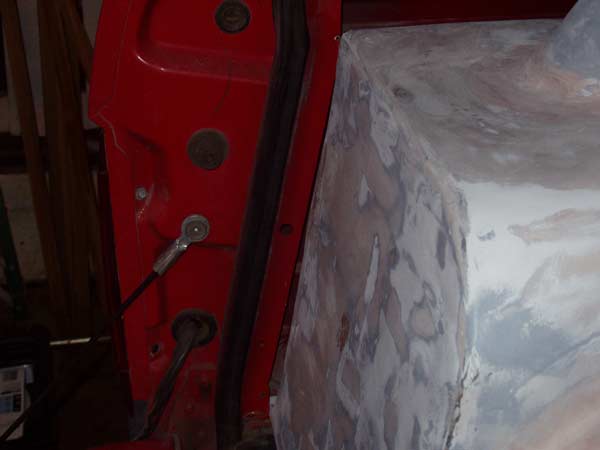

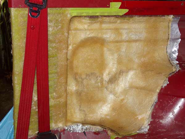

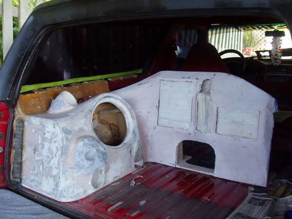

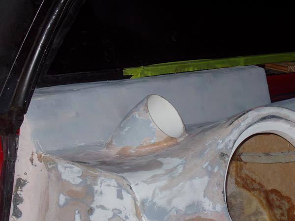

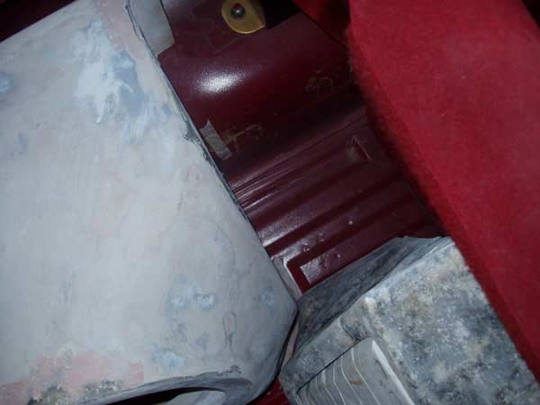

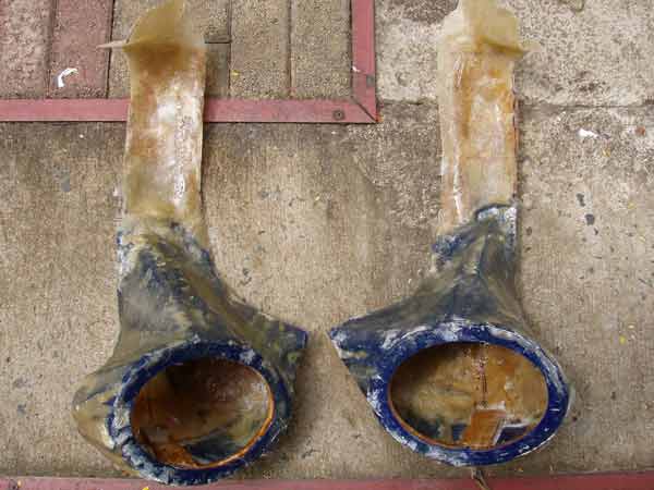

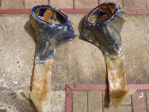

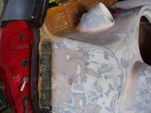

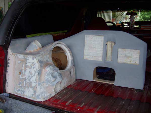

Just a few more "sand time" to complete the box and the amp rack.  I finished the corners of the box and tested in the Bronco. Everything fits well.
posted_image
posted_image
posted_image
I just need to smooth the upper side of the box a little bit more to complete it.
posted_image

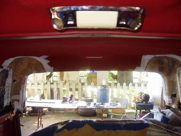

Date Posted: August 15, 2005 at 9:32 AM

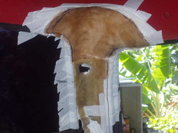

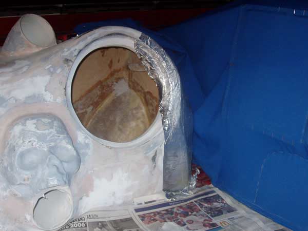

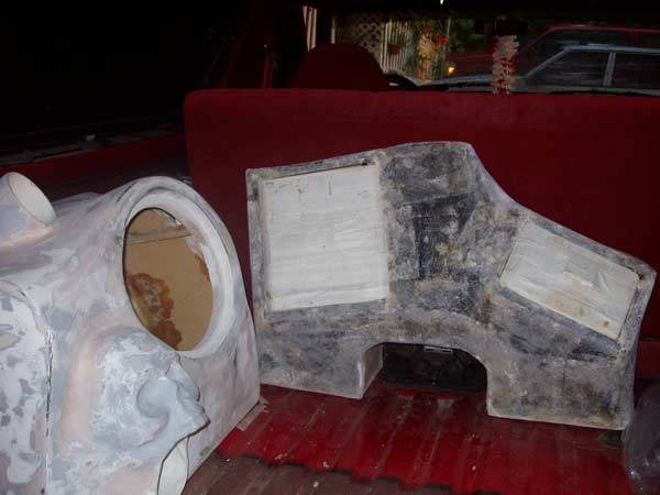

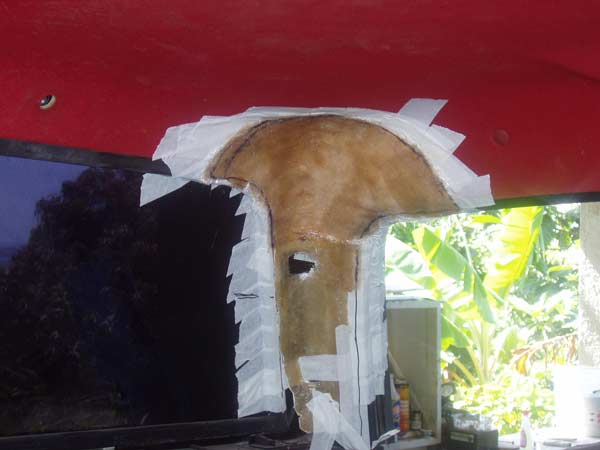

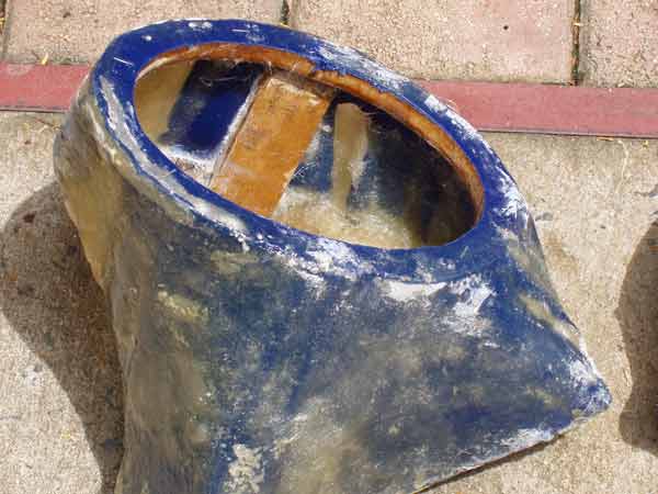

Here are some pics of my progress.  Since I started college studies, time will be limited but I'll do my best to finish this work this year (s**t) posted_image Everything is taking too much time (when just one person is working on this project, me).  I'll be patient and ask for you guys to get some also.
Enjoy and Post your comments, please.  They have been very helpful with the progress posted_image
posted_image
posted_image
posted_image
posted_image
posted_image
posted_image
posted_image
posted_image
posted_image
posted_image
posted_image
posted_image
posted_image
posted_image
This is it!  I did the bondo part but no pics of it right now.  I'll be posting them next week.  posted_image
