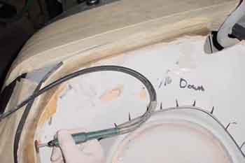

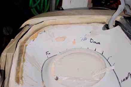

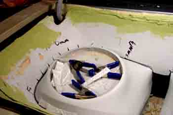

Posted By: branvw
Date Posted: October 24, 2005 at 9:35 PM
so this is how i am fixing this problem....first i cut the top down 1"
posted_image
then i glassed a lip all the way around the box, this will act as a shelf
posted_image
then i trimmed the edge smooth with a mini cutting disk
posted_image

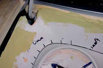

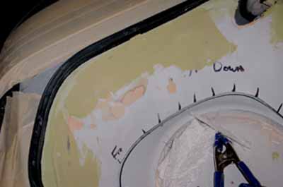

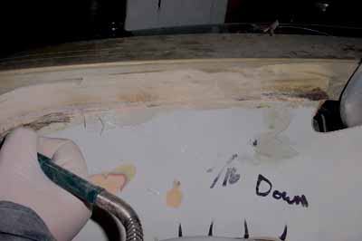

after filling it up to the trunk gasket this is what it looks like
posted_image
posted_image
posted_image
now taking shape
now alot of sanding and all will be good, should be posting some final pics soon.  Starting the amp rack this week too!
