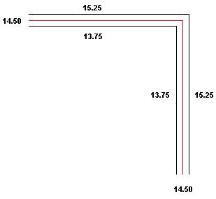

Just make sure, as far as the length goes, that you're measuring in the center of the port. For example, the port turns 90 degrees right in the middle. You'll be measuring 14.5 inches (29" divided by two) in the center, whereas the outside of the port will measure 15.25 inches on either side of the angle, and the inside of the port will measure 13.75 inches on each side. example (measure the red line)
