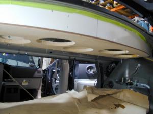

Posted By: Velocity Motors
Date Posted: March 17, 2006 at 8:51 PM
To fiberglass a vertical wall or to glass the bottom of a deck lid you will need to mask off the deck lid from the bottom & then apply a coat of PAM ( the cooking spray ) to the masked area. Next you will want to take some 2 or 3 layers of tin foil larger than the area that you want glassed and spray a layer of PAM on it. Next take some fiberglass matting and resin& apply this to the tin foil on the side that the Pam is sprayed onto. I would say about 3 layers of matting would suffice and once you have this glass on the tinfoil & soaked with resin apply this to the surface of the deck lid or vertical wall that you has masked off and sprayed with Pam. Use masking tape to hold up the edges and for the middle you can use a peice of MDF or wood the same area along with a peice of 1" foam and use some milk crates or books to hold it up in the middle section. The pressure of the foam will contour to the bottom of the deck lid where there are valleys and rises perfectly. Allow to dry and when you remove the mold the tin foil will peel right off.
Date Posted: March 18, 2006 at 6:22 PM
crazyoldcougar wrote:
i have no idea what that other guy is talking about..with the pam and aluminum foil..but anyway...
The "other guy" has been doing this type of fiberglass work for the past 8 years and have built many systems with different techniques. I told the member Pam because it's an oil based biodegradable spray agent that you can buy anywhere. I could have steered him to PVA  but unless you know what it is or know whereto readily buy this, it's not worth mentioning. Heck, even silicone spay or Turtle Wax would work too as long as it's a barrier between the fiberglass and the tin foil.
first the foil will release from the fiberglass without the help of cooking spray.....
With a release agent on there it will just come off. Without it, you will need to peel it off with your finger nails and if there are wrinkles in the foil, good luck trying to take the foil off the mold.
second...fiberglassing vertically and on undersides is not impossible...it is just very difficult as the mat tends to sag...and resin drips everywhere..
This is why I suggested applying the mat & resin onto a peice of foil first & then taking this foil and appying it to a masked off area with the PAM. Using the foam & MDF board will allow the pressure to be applied to areas that have dips and rises therefore allowing you to be able to do more than one layer at a time. With the added support of the MDF, there will be no sagging and the foam will take care of the dips in the underdash area where it would normally just fall. Using something to hold up the pressure for the MDF & foam will give the fiberglass a  smooth contour to the base of the underdash.
