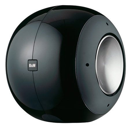

i cant seem to upload a good picture of the bang and olufsen sub but heres something similar to the idea I have
posted_image
and yes, i plan on piano black as well, so thats probably exaclty how i would want it to look. and i planned on running a dayton reference high fidelity 12" with a crown XLS-202.
any suggestions on how i could start this? I was thinking maybe getting a really big styrofoam ball or something and coating that to get an initial shape?
what do you guys think?

I like the B&W much more than the the B&O. If you want to make it off a styrofoam ball, you have to decide if you're going to use a sacrificial mold or if you're going to cast a seperate mold to get this shape.

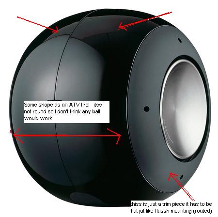

Posted By: thegreatbondini
Date Posted: May 16, 2006 at 8:40 PM
That really looks interesting , Got my wheels to turning, The first thought I had was to mold the inside of an atv tire maybe even fill it with great stuff (expanding foam) cut rubber off after dry and you should have the basic shape.and then just go from there. But as we all know sometimes it takes more than a few thoughts before it works
Date Posted: May 24, 2006 at 3:58 PM
posted_image

Posted By: eternal1
Date Posted: May 25, 2006 at 7:34 AM
im not seeing an atv tire. sorry. but i do get what you are getting at with that idea. i still think a beach ball with a speaker ring out of wood glued to it wrapped in fleece would be the perfect shape.
