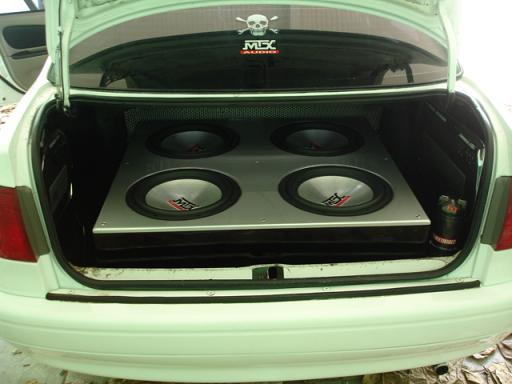

Posted By: Aruman
Date Posted: June 07, 2006 at 5:13 PM
Aceracer24 don't go with 9500 or 8500's, go with the 7500's they are more effiecient and they have great SPL with less power and in sealbox, i'm very happy with them. i know i don't have any experience with the 8500's but when i went to buy the 8500 series 4 of them my MTX dealder told me not to go with them, to go with the 7500's so i was confused about that why in the H.. don't go with 8500???, so i went online and ask different people, so i came to an website of MTX in Europe where the guy there have experience with all MTX subs and he also told me the same, so now i have 4 7500, and they hit pretty damn hard. here's a pic of my current system, i'm still not finish, when i finish my car i'll post more pics of my system and car. posted_image

Posted By: killer sonata
Date Posted: June 07, 2006 at 5:51 PM
Nice install aruman! I bet that does hit retty good. Does the MTX sticker give you added horsepower? lol just kiddin man.

Posted By: Aruman
Date Posted: June 07, 2006 at 9:29 PM
yes Killer Sonata it gives me better Horse Power, posted_image
