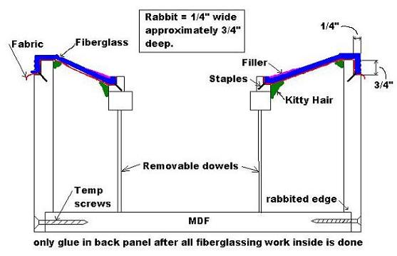

Posted By: crazyoldcougar
Date Posted: August 27, 2006 at 12:13 PM
this is as basic as i can draw it for you...
essentially all the edges are rabbited more or less..
posted_image

Date Posted: August 27, 2006 at 12:43 PM
Cool thanks alot, that's just what I needed. I'm gonna start the fiberglassing in a couple of weeks or so and post some pics. I'm going on vaca for 10 days, and when i get back I have to take apart the box to rabbit those edges. One more Q though, you said don't attach the back until all fg work inside is done.... my box right now is ready to go I can install subs and listen, it's just that I put and overhanging lip 3" around each side so I can add 2-3 layers JUST FOR THE LOOK. right now, the sub box is functional, just looks bad. Do I need to change the box and remove the front face so I can work witht he fg on the inside of the box? Thx again for the drawing.
Date Posted: August 29, 2006 at 8:54 PM
i dont think it is necessary to rebuild the box...but you could end up with the "new" front sealed chamber resonating..between the mdf face and the new fibergalss face i mean..
as for your situation you are going to have a hard time attaching to sub cut out...you are most likely going to have to build a trim ring that fits just outside the outter edge of the sub, rabbit it and then go from there...
