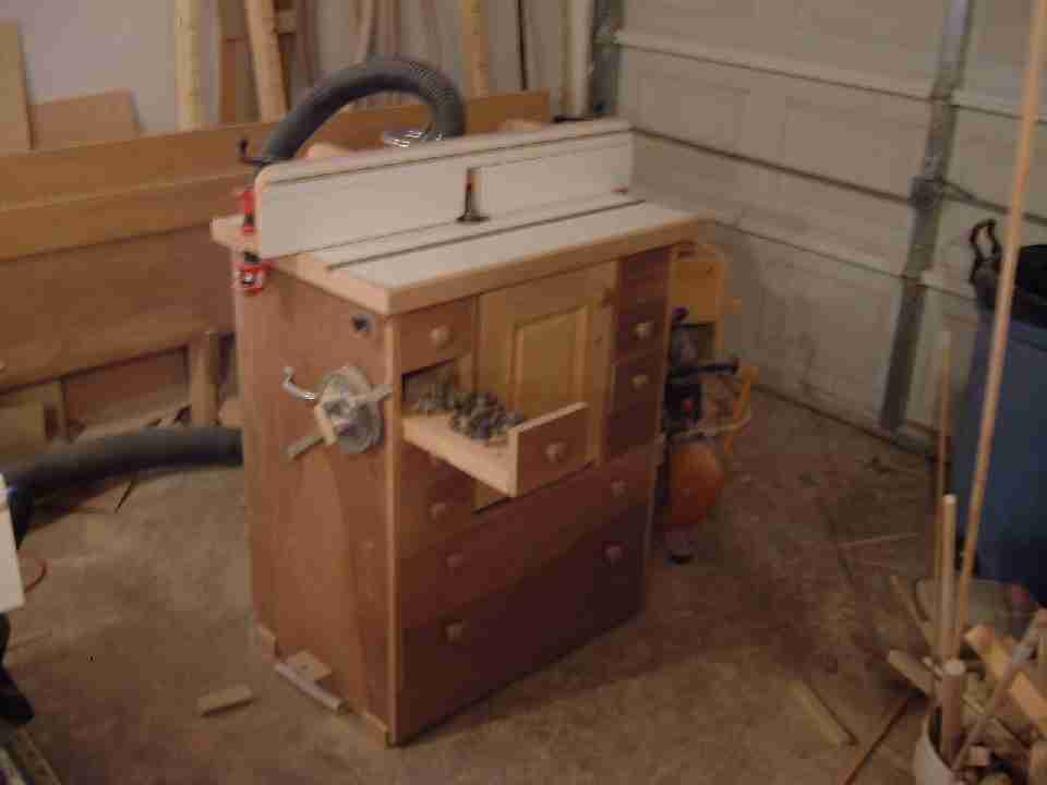

Here is a picture (low resolution) of my current router table.  A router table does not need to be this elaborate.  Mine has a built-in lift and follows the general layout of the one on the popular woodworking show on pbs - new yankee woodshop.  The top is a sink cut-out.  Nice high density particle board with laminate already installed and cheap.  I laminated a piece of 3/4 plywood to is and wrapped the edge with maple.  The lift is on the back of the cabinet so the top hinges up for bit replacement.  posted_image
