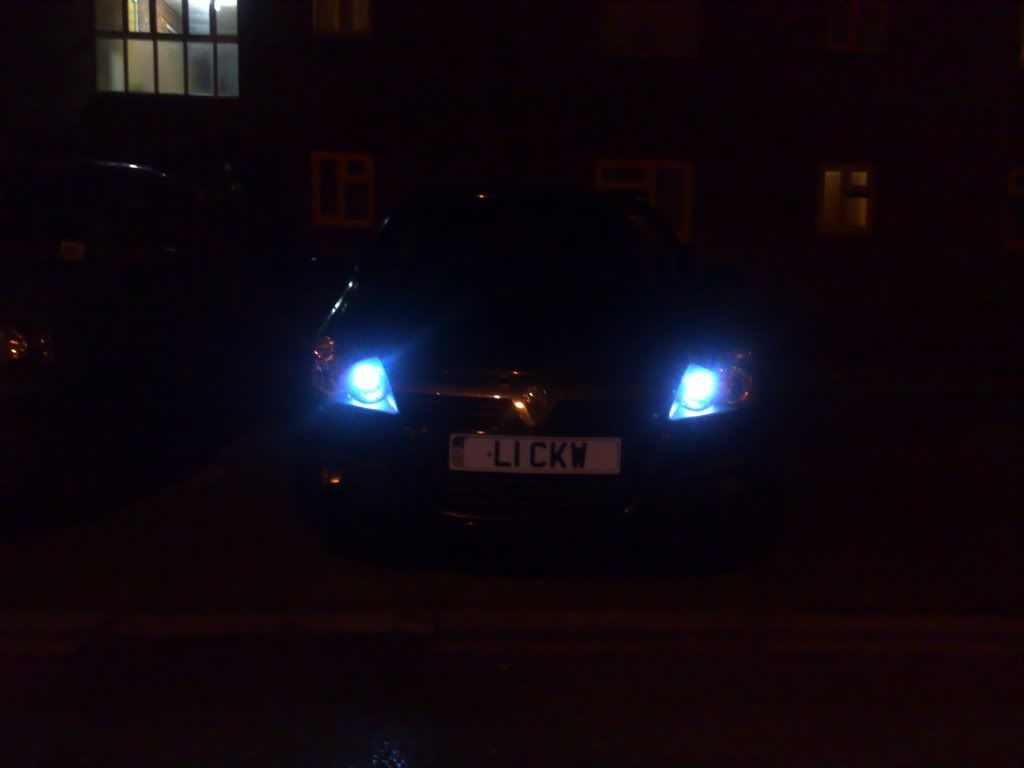

these are the figures
  • 11 - 16 V dc
  • 100 ma power consumption
  • Fully Regulated - Designed to last
  • this is the bulb - its a 501 wedge type bulb
    [IMG]https://img.photobucket.com/albums/v653/c12k11w79li/u501whp3.jpg[/IMG]

    Date Posted: March 11, 2008 at 6:55 AM
    just not turning on when i put the side lights on

    Posted By: dudehitt
    Date Posted: March 11, 2008 at 10:48 AM
    did you try turning them around?  LED's are polarized, unlike regular bulbs.

    Posted By: chrish sri
    Date Posted: March 11, 2008 at 2:19 PM
    Top man it worked cheers
