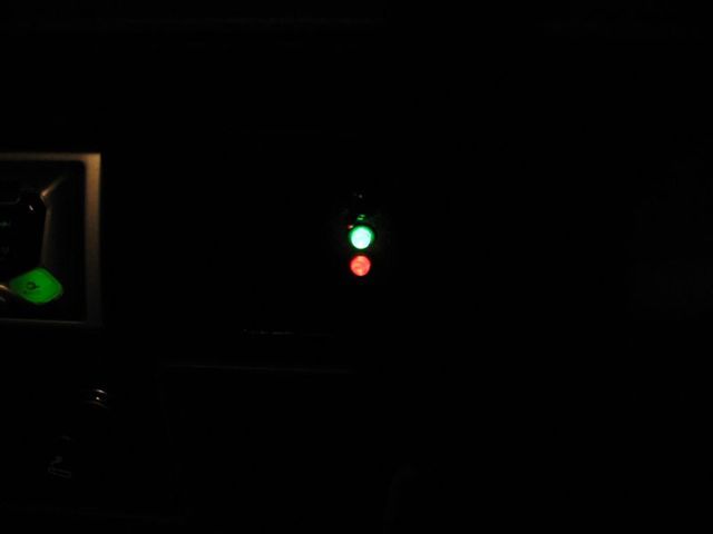

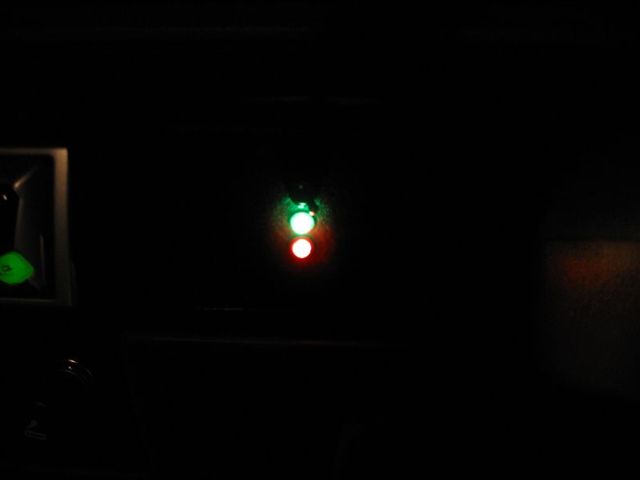

All done and works fantastic, ended up being the 10K that worked the best...
There's a Photo if anyone wants to see the set upposted_image
Thanks to i am an idiotposted_image

Forgot to add the pics so here there areposted_image
