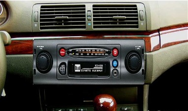

Car w/ Stereo Sold. Now driving a 2004 BMW 330xi w/ premium sound package (harman kardon).
Just curious, that radio in the BMW looks a lot like a Dual.  ???

Indeed! Good to hear from you again!
Dual... posted_image Sure, but at least there is a front input jack for feeding in those super HiFi mp3's!
