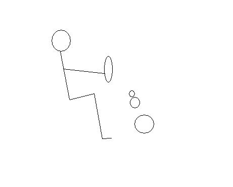

The drivers will all be in basic open-back installation... IF you can get the mid sealed away from the door cavity, that'd be best... The description of what you have in mind for the mid install works perfectly, I think... So, ideally, you'll have TangBang in IB, SilverFlute in a small sealed cavity, with a bit of stuffing, and the tweeter will be a sealed back (won't really matter, tho... it's already sealed from the back) The most important spacing here is the mid/tweeter... They NEED to be as close together as is practical, and the mid's edge should be (ideally) no further from the woofer's edge than 5 or 6 inches. (And I am talking about the CONE, not the basket...) Closer is better!
Also, if you can "tip" the mid and tweeter, say 10 to 15 degrees, especially on the driver's side, to point a little bit more toward your ears, ("toward the dome light", as you said early on) that'll GREATLY help your sound power.
Here is what I was talking about with the "array"...
posted_image
Now... refresh my memory as to what signal processing you have, please? I mean everything in the deck, any external procesors, and whatever crossovers are available in the amps...
IIRC, we will be active at the sub to TB, active with the TB to SF, and passive low-pass on the SF, and passive high pass on the Vifa... Do I, in fact, remember corretly? These will also have 6 discrete channels of amplification, as well... Right? If so, then wou will be running 3 pairs of speaker wire to each door. (Leave plenty of extra for the mid and tweeter, so we can insert the passive crossovers right there at the driver - this will prevent any cable interaction from affecting the driver and crossover response) Anything over 18 gauge will be plenty, but bigger looks cooler, I think... Judges like the bling, too! posted_image
