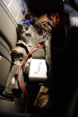

Step the first: measure cabin gain of my vehicle
A subwoofer sitting on the shelf in a store will sound different when installed in your car, and it will sound completely different if sitting out in the open or in an anechoic chamber. Ever notice how subwoofers in an electronics store are usually contained in a small room you have to walk into in order to listen to them (hint hint)? The interior shape and size of your car, the materials used to build the car, and any stuff you have inside it will affect the frequency response of the subwoofer. Each car is unique in this respect, and so is every dining room for home theater installations (my other hobby). This effect is called cabin gain.
To measure how my car will affect the response of my transmission line, I needed to run a few tests. First, I placed my home theater sub (a Bowers & Wilkins ASW600) on a chair in my backyard, careful to make sure it was not near any large walls or objects that might alter the response. Then I played test tones and measured the response of the sub out in the open, which is as close as I can get to an anechoic chamber which is what all enclosure simulation and calculating software assumes. Then I repeated the test placing my ASW600 sub in my car facing rearward like I plan the transmission line to.
I used a Belar spectrum analyzer connected to the best microphone I could find for this test. It is a Sennhieser 421 which has a frequency response rated down to 30hz, the lowest I can get my hands on. This is important to remember, any values below 30hz must be accepted with a grain of salt, they are not as accurate as the higher frequencies. There is a microphone preamplifier between the Sennhieser and the Belar, which should be transparent to these tests. The mic was placed one foot in front of the woofer in my backyard, and was sitting on a small mic stand in my front seat when the sub was in my car. After many attempts both inside the car and out, waiting for the wind to die down and averaging the data over many minutes, I came up with the following two graphs.
posted_image
And here's the result I was looking for. This is simply the difference of the two lines in the previous graph, and it shows how my vehicle affects the frequency response of a sub.
posted_image
So, what does this all mean? Looking at the first graph first, the sub placed in my backyard has a fairly gentle roll off from about 55hz and lower. When placed inside my car the response peaks sharply at about 55hz and rolls off in both directions. The data I want from this test is in the second graph. Other than a peak at 28hz, there is a rise of 8db from 20hz to 60hz. The slope from 60hz and up can be disregarded because I will have a low-pass filter on the amplifier anyhow. Good to know! Now I can keep this in mind going forward, to make sure my transmission line compliments the cabin gain of my car.

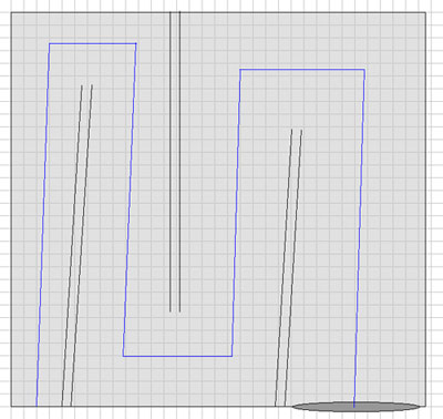

Step the second: design hypothetical subwoofer to compliment measured cabin gain
Lets start with a picture.
posted_image
Or not, I'm not sure what the issue is, I can't see the picture on my preview window here. Anyhow, what I'm trying to show is the measured cabin gain, and the response of a hypothetical sub I want to build. From 20 to 60hz, the cabin gain increases by 8db. So my sub would have to decrease by 8db in order to have a flat response when installed in the car.
Having such a low frequency peak and roll off on the high side is not easy to do when building a sub, and very difficult with a sealed or vented enclosure. A bandpass might be able to, but would need a resonant frequency terribly low and the enclosure would grow huge in size. The transmission line however, can extend the response of a woofer well below it's resonant frequency, and be really efficient while doing it. Have you ever heard of a single 4" woofer achieve response down to 35hz!? It's been done, there are a few examples here and here So, expecting a response down to 20hz from a 10" woofer should be no problem, if properly designed!
On the subject of cabinet size, it has to fit in my car. I'd like to not sacrifice all of my cargo room for the box, but I know to do this properly will require a decent amount of space. The box must also be removable in case I need the cargo room. After taking measurements in the rear cargo area of my Jeep behind the back seats, I came up with the following: 34" wide, 33" deep, and as short as possible. The height of the box will be influenced mostly by the woofer choice, how large the woofer is, and the internal volume I need for the transmission line. Thus, the height will be a variable I can play with if I need more or less volume for the transmission line.
So there we have it. The hypothetical subwoofer will be 34" by 33" and some unknown height, removable, and have a frequency response that peaks around 20hz and slops downward towards 60hz. Of course it must also be production quality and look beautiful. On to the next step.

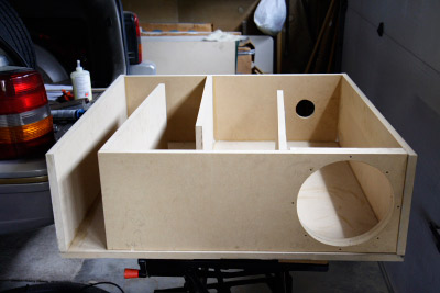

I'm building the box right now actually, should have a rough skeleton done tonight. All the stuff I want to write is lagging behind the build though, otherwise you'd see all the tweaking I've been doing with King's worksheets. But yes, agreed, I'm starting with an unloaded line and plan to add stuffing later if needed. The simulation shows a near perfect match to my cabin gain without stuffing, so perhaps I won't need it. We'll see!

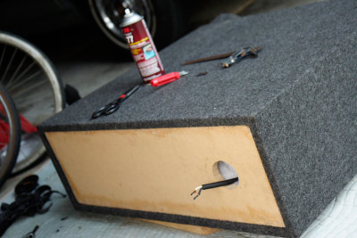

Aaaaand, back on topic. The wood glue and caulk is all dry, the wiring for the amplifier is nearly done, but I need to sand down the box a little bit. The cuts on the MDF were a pinch less than square so the top of the box doesn't seal properly. Looks like tomorrow will be a fun day with the belt sander ...
Stay tuned for more of my research and simulation screencaps, I'll post them later today.

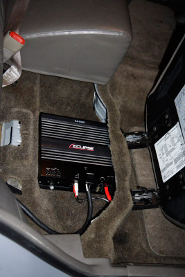

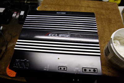

Step the fourth: select amplifier to compliment the woofer in power rating and crossover frequencies
Power ratings are very often misunderstood. To skip a big rant on my part, lets just summarize that RMS power ratings are good, and MAX power ratings are bad. Also, pay attention to the impedance listed right after the wattage. If your amp can do 1kw at 1ohm but you only have one woofer at 4ohms, then you're screwed and wind up with 250w being used. Always match impedance of the woofer(s) and the amplifier.
Crossover frequencies however, are really simple. I want a low-pass filter, which skims away all the high frequency signal and leaves me with just the low frequencies. From the measurements in earlier steps and experience with home theater, I know I want my crossover to be set in the 45hz to 55hz range, so I need to find an amp that can filter this low.
Also, I know that certain designs like the transmission line and the bandpass enclosures have a tendency to blow up woofers if they are overdriven below the system's resonant frequency, much more easily than other boxes. This is often called unloading, where the woofer is no longer encountering resistance to it's movement from the air pressure. The only force restraining it at these frequencies is the surround and the spider materials, not the big cushion of air like in a sealed box. To counter this, I'll find an amplifier that has a subsonic filter to roll-off the frequencies below 20hz or so. Frequencies below about 30hz are often called subsonic and the consumer is often misled to believe these are "bad" or "useless" because we can't hear them. I like to think the opposite.
When you experience music or movies that have sub-30hz material, there is a certain realism that shines. It's like in Jurassic Park when the T-Rex is first introduced in the movie. He doesn't make a big roar, and the characters don't really know what they're hearing when he is approaching. The big clue is the glass of water vibrating with each foot step. The audio is felt, not heard, this is what I want!
So using the websites mentioned above with reviews, I narrowed it down to the following amps:
                    RMS@4     RMS@2     Subsonic
Alpine MRP-500          300     500     15 hz
Eclipse XA1000          320     480     18 hz
Kenwood KAC8104          300     500     15/25
McItosh MCC301M          300     600     20/28
All four of them have exactly what I'm looking for, and match the woofer I choose in power handling (350w RMS). I will run the woofer in 4ohm mode so the 4ohm power rating is what I'm looking at. All of these amps also have a great subsonic filter just below 20hz. I was looking at JL amps however, and their subsonic filters are set at 30hz !? For such such quality products, I cannot for the life of me figure out why they set the filters so high.
Anyhow, the first one of these four I found at a decent price was a used Eclipse XA1000. The McIntosh was tough to find, and they were usually quite expensive : )
Awesome, $85 shipped.

The next step is to set the transmission line length, taper if any, and stuffing if any. This required a LOT of guess-and-check to figure out how the values effect the frequency response of the system. In this step, I was trying to construct the frequency response of my hypothetical subwoofer from step two on the first page. Remember it needs to hit -3db by 20hz, and gradually roll-off by 8db as it approaches 60hz. The dimensions must also be no greater than 34" x 33" and some unknown height to adjust for internal volume.
After some quick drawings, I guesstimated I could put 120" of length inside my enclosure and still have it fit within my cargo area comfortably. So that is the length I started with, and coincidently, the length I ended with.
The tapered line tends to be most popular, because it will allow the shortest line at any given resonant frequency. This means you put the woofer at the large end of a tube and taper the other end into a smaller area, much like a reverse horn but linear rather than exponential. Lots of people have had success with a ratio of between 2:1 and 4:1, so I started with these and kept massaging the numbers little by little. Eventually I settled on a 2.1 : 0.7 ratio. These ratios are based on the surface area of the woofer I'm using, 339cm^2.
posted_image
This is very similar to the 3:1 ratio which I loved, but the internal volume required is more in line with the space I have available. Below is the frequency response curve of the box I plan to build. Not shown here is an impedance vs. frequency graph which shows the system's resonant frequency is at 22hz. The graph below shows much of what I am trying to achieve. The -3db point is in the very low 20's, there is a roll-off going towards 60hz, and for 1-watt of power the system is really efficient.
note: the red line is my box, the blue line is an infinite baffle with the same woofer for comparison. Notice how much more efficient the enclosure is? For the range I'm using, it's about 6db higher meaning 4x the output!
posted_image
There are dozens of graphs and ways to pull data from these worksheets and I don't want to cover them all, but there is one more I am interested in. Will my woofer be moving enough air to make a hissing noise as it passes through the tapered opening? (the terminus) To find out, we can simply scroll down a few pages to find this graph. The recommended highest air velocity is 10m/sec, and this box is close but definitely under the threshold.
posted_image
So there we have it. I need to build a box with 120" length of transmission line, with a taper ratio of 2.1 : 0.7 of the surface area of the woofer. The line must be folded into a box of 34" x 33" and 10.5" tall to house the woofer. The internal volume should be about 170 liters. It would be nice to have access to the entire length of the line so I can tune by adding stuffing later on.

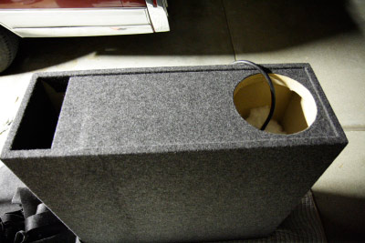

Step the seventh: build enclosure striving for production quality
Using excel, for no other reason than convenience, I began the layout of the enclosure. The picture is the internal dimensions, and each square is one inch. The blue line is the audio path, which came out to nearly 120" as planned. The height of the box internally is 10.5", just a bit larger than the woofer itself. Should be a tight fit!
posted_image

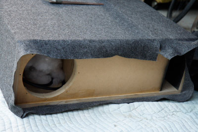

Home Depot was nice enough to cut the wood for me, but I would later find out their saw is not square, curses! Here the box is assembled and glued together, but the top will not fit because none of the top edges are square and will result in massive air leakage. A belt sander and a little while later though, everything was flush and ready to get the top glued on. I added some polyfill at this point, to get a constant density of 0.25 lb/ft^3. There is some screen door fabric inside the line to keep the fiber from spilling out the end.
posted_image
There are a dozen screws along the top surface that helped sandwich it and the vertical pieces together despite all the sanding. I knew it wouldn't be absolutely perfect and wanted to make sure it was touching on all surfaces. The salt and pepper carpet not only hides the screws but also make the box look like a real enclosure, I'm starting to become giddy at this point! Here's a tip for rolling the carpet over the edge and forming a tight inside corner, like in the photo: use a tool with a wheel on the end. I used one designed for tucking in the rubber rings on screen windows, and it made all the difference in the world.
posted_image
The carpet is coming along nicely, except I don't know how to make the seam where two edges meet look decent. The best I can do is put the seam on the bottom of the box. It's clearly visible in the photo, but doesn't look bad once it's turned over.
posted_image
She's done! She's also a bit overweight and I need help to move her haha. I can't help but notice the big empty space between the terminus and the woofer. I'd love to put a big Infinity logo there, but not sure exactly how to make one. Or maybe some abstract art, I'm just not sure. Oh well, a project for another day.

Also, the amplifier arrived in the mail today. It was a steal! The guy selling it posted pictures with moderate "scratches" all over the face and sides. Turns out these are simply sticky gunk and cleaned off easily. Not that it matters though, since it'll be under my back seat and out of view.
posted_image

   teenkertoy an infinity raised letter logo is simple, before carpeting the panel lay dynamat on the panel. Next get an infinity sticker-the size you want-  and stick that to the dynamat, then with an olfa knife carefully cut along the outline of the sticker going through the dynamat... peel excess dynamat off and cover. The best way i have found to do it................. vinyl and suede requires one layer of dynamat , but carpet is thicker so i put two layers of dynamat.  ....nice thread and nice box
Posted By: haemphyst
Date Posted: May 06, 2008 at 12:14 PM
I'm excited FOR you, except I aim more towards .5 pounds per cubic foot... I think your Fs is going to be a bit higher than planned with that light a stuffing density. Until you know the results, be careful of unloading... It might happen higher than expected.
I also stuff heavier toward the woofer, and taper the density toward the terminus end, and AVERAGE .5 pounds per cube, throughout the enclosure. (The way I would approach this would be (with your enclosure - with 4 sections) .75 for the first section, .5 for the second, .25 for the third, and nothing in the 4th...) This seems to offer the best overall response, with the best smoothing on the output. I can only thing that any minute turbulences (wind noises, if you will) induced by the stuffing isn't quite so audible with this method.
Yes, I have found the 1:3 ratio really works well. I have also found that adding a few thin dowels across the line helps quite a bit in preventing stuffing "sag", but generally speaking, it's NOT a huge issue with poly-fill. Acousta-Stuff can settle a little bit, and benefits from this treatment. Long-fiber wool DEFINITELY needs the dowels, but LFW will also provide the BEST results acoustically speaking, at the greatest expense.
That XA1000 is gonna be a perfect match, I'm thinking!
VERY NICE WORK!!! I might be in SJ this weekend! I'll keep you posted! (And seeing yours, I may just be rebuilding mine, soon... Thanks. (Be sure you get the sarcasm there...)) 3 feet square, huh? My first one was that big; built for two Infinity Pro-12's, heavily stuffed, and damped with 300 pounds of sand! LOL Don't talk to ME about "overweight"! posted_image
I like the idea of the Dynamat under the carpet... Very slick, boogeyman!
Posted By: teenkertoy
Date Posted: May 07, 2008 at 2:12 AM
Boogeyman, that's a neat trick. The carpet is already laid and glued, so I'll have to tweak it a bit. I have enough carpet for a 2nd layer on the front though. The trick is to find something dynamat-ish to use, I don't have any of the real stuff. I'm sure the local hardware store will have something I can substitute.   I really like how it looks in my mind, simply raised bumps that doesn't involve chrome, neon lights, plexiglass, or anything that flashes : ) Oh how I hate some of the crap people put in cars...

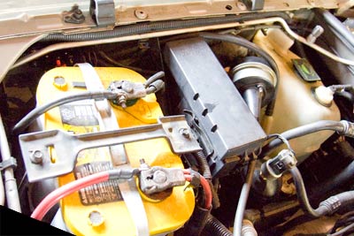

step the eighth: install amp and enclosure, again striving for top quality
I started with the power cable the same time as building the box because I had the materials and my cousin was around for free labor, so he did most of the wire running and taking the dash apart etc. It's really hard to see, but in the top left corner up against the body to the side of the battery is a small black box with a red button and red lever. This is a resettable fuse rated to 140amps. I got the idea from the broadcast vans we use at the radio station, they have similar (though much better quality) resettable fuses on all the battery related cables and I love the idea of being able to turn the power lead on/off at the flip of a switch, and not having to buy more fuses should I ever melt one.
I'm using the side post of the yellow top, which some people say to be careful about due to the internal wiring being inferior to the top posts and not able to handle much current. To that I say, hmph. It's supplying the 40'some'odd amps I need for the amp, so it's all good. You'll notice however I didn't attach my winch to the side posts : ) Also you'll see split loom covering the new 4ga. wire in the engine compartment and you won't see the cute rubber grommet in the firewall.
posted_image

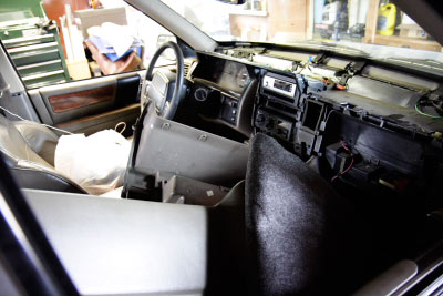

The next two photos are my cousin's handywork making a complete mess of my interior. Taking the dashboard apart to reach the power wire from the firewall, removing the rear seats and pulling up the carpet, and having a grand old time making a mess and cutting his fingers on everything sharp he can find.
posted_image
posted_image
Below is the final amplifier installation. The 4ga. power cable is going directly to it for now, but I plan to add a distribution block at some point in the future to power the amp for the components, which also need replacing. Especially after this install, the components I have are sticking out like a sore thumb! Damn they sound bad...
posted_image

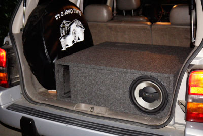

The last photo is what this project is all about. The transmission line is sitting happily in my cargo area, perfectly nestled against the spare tire and the wheel well, and between the rear seat and the molding along the floor. It ain't going anywhere! And I have to add, it's damn beautiful. The picture doesn't really do it justice because the project was finished too late at night and I had to use a flash : (
posted_image
