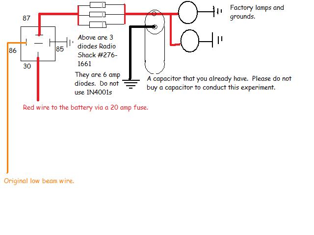

Hey if somebody has a stiffening cap laying around and wants to stop their headlights from dimming, I have a plan that should work.  I do not want you to go and buy a cap but if you have one and want to try this, let me know how it works.  A (.)5 farad cap should be plenty.  If you use a 1 farad you may need 4 diodes to handle the charge current.  You will be charging the cap everytime you turn on the lights.  The diodes are necessary, they prevent the current from supplying the amplifier.  For testing purposes you could simply connect the diodes, the cap and a headlamp bulb to try it.  Let me know if it works.
posted_image
Posted By: bullseye753
Date Posted: July 25, 2008 at 12:30 PM
I  may give that a try.. i have a .5 farad RF cap laying around
