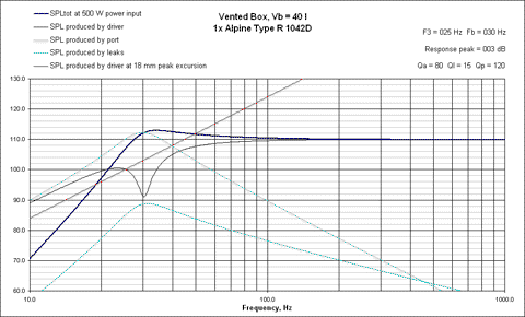

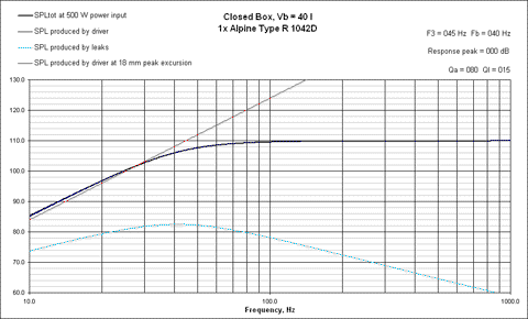

Here are some Unibox predicted output models in your 1.4 cuft (net) enclosure with a single 1042D @ 500watts, first is sealed, second is vented (ported at 30Hz.)  I recommend porting your enclosure at 30Hz.

Ok, that's a huge vent...I'm just gonna stick with what I have for now...when I get my comps and I put in my second amp and amp rack I'll just build another box then. Probably in a couple months is when I'll be ready to do it, til then I'll just suffer without the bass.

Not such a huge vent... 4" X 23".  Unibox is pretty accurate and easy to use.  Not as powerful as WinISD, but a much shorter learning curve.  Enjoy.
