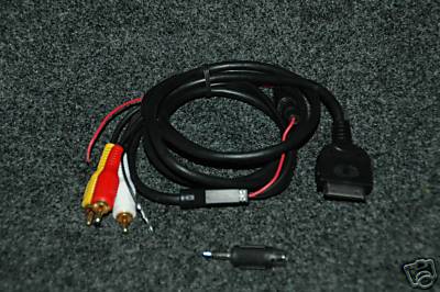

Date Posted: September 05, 2008 at 8:40 PM
posted_image
Posted By: reax222
Date Posted: September 05, 2008 at 9:21 PM
That will probably be a champ. Plug that into the eq along with your PS2, you will probably want to use the accessory wire under the column and add a switch for your remote turn on. Then the rest will be a normal install.
