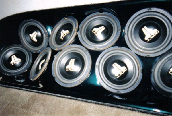

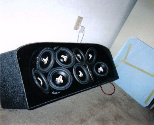

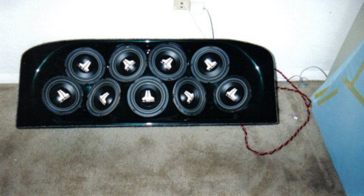

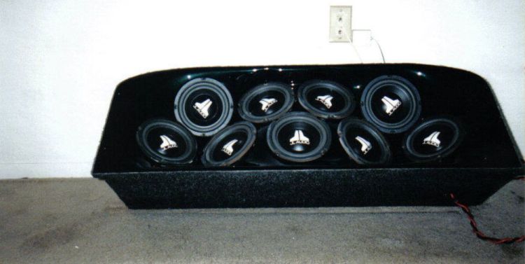

mcben789, this is the enclosure i had in my last car. little subs, big sound. 9 JL 6W0's in a custom fiberglass enclosure. it sounds absolutely incredible and is pretty small altogether. doesnt need a ton a power either. dont have this car anymore now, and i have a different setup. interested in buying the box sub's and all?? pretty cheap. just have the box repainted what ever color you want.

Posted By: ckeeler
Date Posted: November 03, 2008 at 5:59 PM
not trying to just sell a box here but, thay sound absolutely awesome! because they are a 6" subwoofer they are fast and quick. really tight. and with 9 of them you get way huge sound. dont get me wrong its nothing like hearing you a block away or anything like that. when i built that box i wasnt wanting that by any means, i was going for sound quality more than anything else but i was astounded at the output. does just as good as any pair of 10's or a single 12. and when i opened my trunk to show people that they were 6" subs, they freaked.

yes, they are. on a side note, this box weighs a friggin ton. the front is overkill, i made it 1" thick and looking back now, that was a little overkill, but whats done is done.
