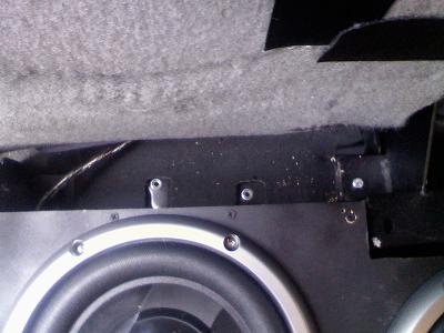

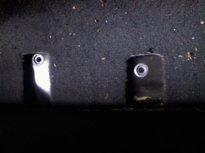

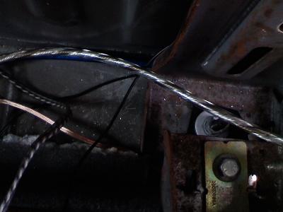

yes I've added the Big three in the 2 month spand my Rockford Fosgate was out and Upgraded all of my wires to 0-gauge. I have a small capacitor so I had an Idea of the voltage drop from 14.2v to 10v (never 9v)... Note* At this time in my life i didnt know the importance of voltage drop. I just happen to be looking for a thread about batteries and that was this year. So now I figured "this has to be one of the biggest problems my amp keeps having and frying on me." So i upgraded the wires and got the amplifier back from rockford about a month later. When I hooked it up from about 40hz + the bass sounded great, it was strong, the voltage was only going down to 12- or high 11v on long continous notes. But anything 39hz and less (a drop beat) the voltage would drop to 7volts! and Even with my last T10001bd's WITHOUT THE BIG 3 It never dropped that low no matter if the engine was on or off. So i knew it had to be a problem either with my grounds (but i didnt see how since the other notes had absolutely no problem at even full tilt & and my other amps didnt either) or the amp just not getting fixed completely. I measured the resistance throughout the grounds, and that all cameout below 1 ohm of resistance. Then I got a old amp from out of the shed and tested it (on subs), and no major voltage drops at any note. I put the T10001bd Back in and turned it on to play it and it was going good until it dropped once and *Pop* some smoke came out and I cringed. Now for the next amp I am going to put wood where the amps are mounted because I have had a problem with amps going into Protect mode because they were mounted on the metal. So im going to eliminate that problem from the start. (T10001bd was not touching metal I bought the plastic things from walmart that you put in the hole first and then put screws in the plastic casing to mount it. Anyone know why amps would go into protect when mounted on metal? Now im looking to change my ground to this Area. Nice and short to my Ground Dist. (Which will be about 6 inches away from the rail)
^^On the Metal Rails that are mounted to the floor (Metal to Metal & no paint in between) of the Cab.^^ Or on the floor of the Cab where I have seen many grounds in These ford trucks Before

1: "The rule of 10". Actually, I kinda like that... It's a bit oversimplified for me, but it does seem to work for most amps out there. Not a bad method for John Q. Public to test the honesty of the manufacturer. 2: I have no intention of "laying it on you". (Unless you say please... ) I would look into the underhood wiring when trying to find a major drop like that. The body and chassis are isolated on most domestics, leading me to believe (as does soundcontrol) that there is an issue with your grounds, and ONLY in the grounds. I know you said it only started recently, but it could be coincidence that it started with the new amp. Where, PRECISELY, are your amp grounds connected? Are the grounds dedicated to each amp, or do they share a ground point? I would personally (and I did this in my system) ground both of the amps to the negative terminal of the cap, THEN run a single wire of EQUIVALENT GAUGE OR LARGER to a single solid ground point on the body or chassis. Are these significantly larger amps than the old ones - the ones you never got the voltage drop with? Where did you get the HO alternator? IS IT, in fact, a purpose built HO alternator, or is it a re-wound OEM alternator, claiming to be an HO device? I ask, because oftentimes rewound alts DON'T GET NEW DIODES!!! One or two things to consider there...

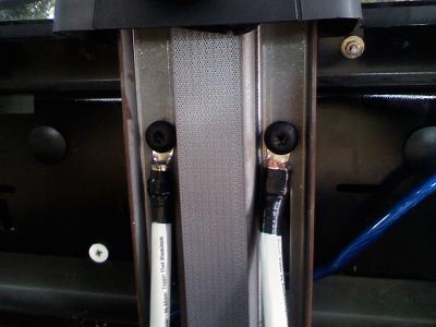

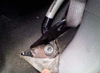

And that Rail is bolted to the Paintless Cab on the Floor. (Rail is on the right & is about 4mm Thick) Broke 2 Drill Bits Trying to Go through it.

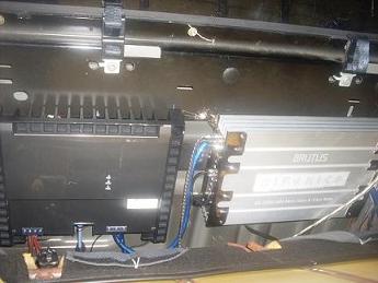

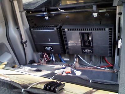

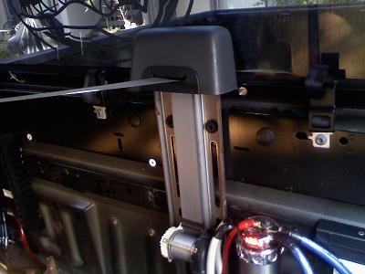

With the new ground ^^^ the voltage increased from 13.8v to 14.2v (at idle) So I thought that was impressive... right? The Amp is sharing a Common Ground The (Left wire) with the Cap (Right wire) right now to keep its Length as short as possible. Or should it just be ON the negative terminal? 2. I have my Midrange amp grounded to a bolt to the left of the truck(cap on the right Close to the Sub amp). The ground (from T3002) would have to reach 2.5ft+ to get to the cap. Is that a ok distance? I have a Extra Un-Fused Distrobution block that I can use from the Neg Cap terminal to Both AMps. 2. The Battery is 850 CCA and I hope its charged 3. All of my Sub amps have been T10001bd that the voltage never dropped to 7v and seemed to destroy my electrical system like it was doing recently. **Note- I tested a old amp (Different Kind) with the same wiring and it did not drop the voltage below 11v** 4. I wouldnt mind getting a second battery but I've heard bad stories about wet-cell batteries in vehicles. It just seems too Dangerous now. 5. The wiring From Battery to Cap and CAP to SUB amp is 0 gauge. The T3002 has all 4 Gauge. Distributed from a block from the Caps Positive terminal. 6. Alright And how should I go about testing my grounds under the hood. Should I test for Voltage with Pos from Battery to Ground? or should I check for resistence between Battery (-) terminal and the other ground point? ------------- I can't hear you! Posted By: rfhvhtoo Date Posted: May 23, 2009 at 11:50 AM Well I Just added another Ground wire that I saw under the hood That wasnt mentioned and now im Idling at 14.39v instead of 14.28.. any little bit helps right? And the does the (+) to Alt from battery need to be fused or what? I got the fuses I just need to go and buy the fuse holder if i need it. ------------- I can't hear you! Posted By: soundcontrol Date Posted: May 23, 2009 at 4:37 PM You've done all the right things to get your system wired really well. I'm not a big fan of going to seat belt bolts or things like that but it seems to be ok with your T3002. I've done some installs with longer then recommended grounds and never had any problems. Especially when its not your larger powered amp. When you ground it properly, with the correct size wire you will notice that the measured resistance for the wire is very little.(especially when compared to a wire that is shorter) The only thing I would consider changing is the grounds to the metal rail. I can't say that is the cause of your problem at this point but it's the only other thing left that I would change. When you can move them down a few feet to get to the actual source instead of something that is connected to it I think that is the way to go. The measeured resistance of the little extra length in wire is probably lower then the resistance of the metal connected to the cab of your truck. For the wire going from your alt to your battery it's up to you. It never hurts to put a fuse on something. I didn't on my car because it was a direct wire about 2.5 feet that doesn't touch anything in between except some plastic tubing it is zip tied to. "3. All of my Sub amps have been T10001bd that the voltage never dropped to 7v and seemed to destroy my electrical system like it was doing recently. **Note- I tested a old amp (Different Kind) with the same wiring and it did not drop the voltage below 11v**" What kind of amp did you use to test the wiring?(make and model) Or what kind of possible current draw does it have? 6. Alright And how should I go about testing my grounds under the hood. Should I test for Voltage with Pos from Battery to Ground? or should I check for resistence between Battery (-) terminal and the other ground point? Both. I think the battery pos to ground I would do first, then the resistance. If all the battery positive to grounds test to be the same then the resistance measurement will only confirm that they are all similar resistance. If one test way off from the rest the resistance measusrement may show why. Loose connection or bad crimp or terminal ect. ------------- Just do something Posted By: rfhvhtoo Date Posted: May 24, 2009 at 5:48 PM I Just got the Hofonics amp installed and adjusted the the gains and other frequency knobs to my needs. So Far so Good. No Major Voltage Drops. Not really Catching any drops below 11.5v. and keep in mind this is from the Demand of the T3002 (700- 800wrms) (Birth sheet reads 901wrms Bridged @2ohms) and the BXI2408D Amp. So I may or may not have a ground problem but It has seemingly gone away. But I think I am finished with it for a while. I've done these upgrades and I just want to enjoy it now. ------------- I can't hear you! Posted By: soundcontrol Date Posted: May 24, 2009 at 8:12 PM Good deal. Hope it works well. It should be loud. Post pics when you get time. Also, did you mention early having dual mid bass speakers in the doors? If so if you have pics of that could you post it as well. ------------- Just do something Posted By: rfhvhtoo Date Posted: May 25, 2009 at 12:15 AM I only have 1 speaker in each door. In the Supercabs they have speakers in the front and Back-suicide doors. But Yeah Ill post some pictures as soon as I can. I Should be able to tomorrow ------------- I can't hear you! Posted By: rfhvhtoo Date Posted: May 25, 2009 at 8:50 PM Here's the Set up... as of now Power Acoustik Deck And Clarion Equalizer

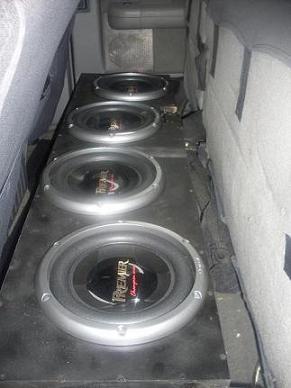

Rockford Fosgate T3002 (4 gauge connects) & Hifonics BXI2408D (0 gauge Connects). 3F Capacitor to the right of the Amps

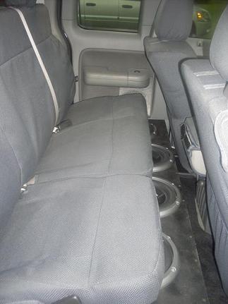

4 10inch Pioneer Premiers in self made enclosure
After the Fiber Glass Box I will be finished for a while. Thanks for the help everybody ------------- I can't hear you! Posted By: aznboi3644 Date Posted: May 26, 2009 at 2:10 PM Fiberglass box would be around 400-500 dollars...thats what the shop near me charges.
