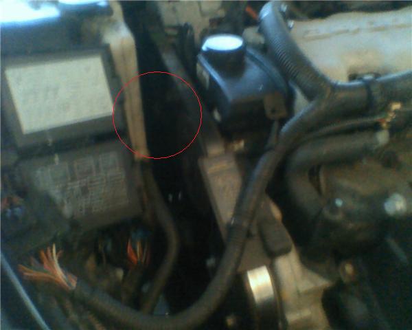

i believe this would be the easiest spot to run
power wire through, it's a huge square on either side of the firewall, you could easily fit 0ga without having to cut anything.  all you'd have to do is run the wire down the firewall and get underneat to push it through to the other side, i don't own jackstands so i can't take a picture of the grommit outside of the car.  but it's literally just a square towards the bottom of the firewall.
posted_image
i'm not a professional by any means, but THAT is where my power wire is going until someone tells me i'm wrong.

posted_image
the grommit is somewhere down in this area.   remember that it's at the very bottom of the firewall, you'll miss it if you're not paying attention.  but it's seriously just an empty square down there.

posted_imageOMG IM SORRY THAT LAST POST WAS HUGE!!!! here it is in smaller form....

okay, so sorry for any confusiion but on the engine side of the grommit there is like a pyramid like grommit.  if you shove the wire in from the cab, you will end up in this grommit.   i just cut and sealed it.  i found it easiest to work on the grommit from the engine side by taking off the passenger side wheel.
i hope i wasable to help someone out.
