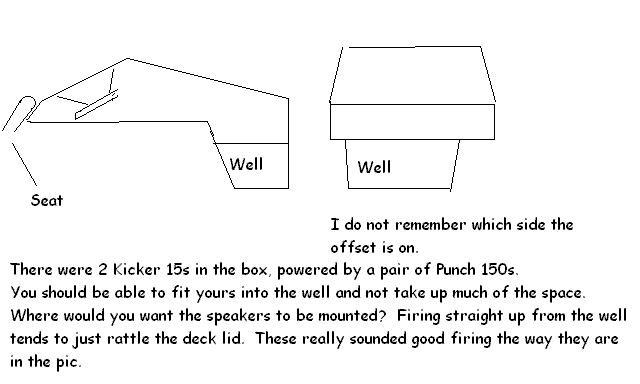

Only problem with them firing straight up is that it just rattles the deck lid and does not sound all that good. Following is a (from what I can remember about it) diagram of the box I built.

hmmmm that is something that i did not even think of.....i did want them to be moutned right above the well but i was gonna have the top part at a angle so that they were not pointing striaght at the back well ya kno?  would that work any better?
and i like that sub box design but is it legal? like can you still see out the back?....btw the offset is correct

Date Posted: June 19, 2009 at 11:01 PM
Yes you could still see out the back. It only made it up to the middle of the window.
Any angle will help. The rattling can now be cured with Dynamat, they make some just for panels and rear decks.
