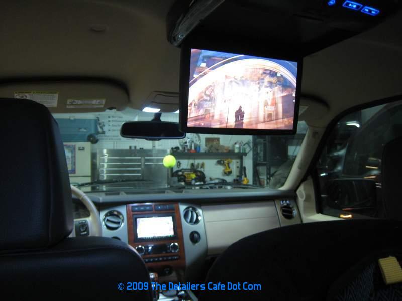

Thanks again guys, got her all installed again last night...hooked it up to the overhead Alpine DVD screen too. works great and we didn't have to drop the head liner again...most of all...momma is happy with it.

Posted By: rollingrocktx
Date Posted: June 26, 2009 at 3:54 PM
sorry those links didn't work...
posted_image
posted_image
