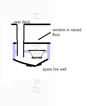

gotcha, ya in my prelude I eventually had to remove the rear deck speakers because of phase differences with subs. I had Diamond HEX 6"'s and 5 1/4"'s in custom front door panels though. I also fiberglassed the subs enclosure in the spare tire well so they sat flush with the normal trunk floor. The trunk space was the area for sound to kind of process before it reached your ears. Or so thought by me. Still I wasnt happy with the sound. Later I added 4" to the enclosure and sealed that chamber making a single reflex bandpass. The raised floor had a window to see the subs. After tuning that, I got the sound I was determined to have. I wont toot my own horn on the bass I had but man, it was all worth it and then some.
