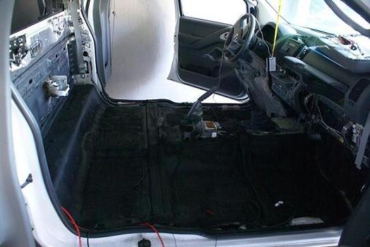

Walk in already knowing what you want and need. 12v is your new digital consultant.(You can nickname it) Specify what you want done. Ask again if you dont understand. Be PATIENT for things if he can order them. Or, believe your best interests on this investment is your dealers priority. Sound proofing importance is sooo underrated.   8 cans undercoat, 2 cans acoustic foam and 5 18"X36" sheets of Dynamat Extreme. Worth every penny, not a single rattle.
posted_image
This is what I do for FUN!

Date Posted: July 12, 2009 at 6:19 PM
how much did you pay for all that?
