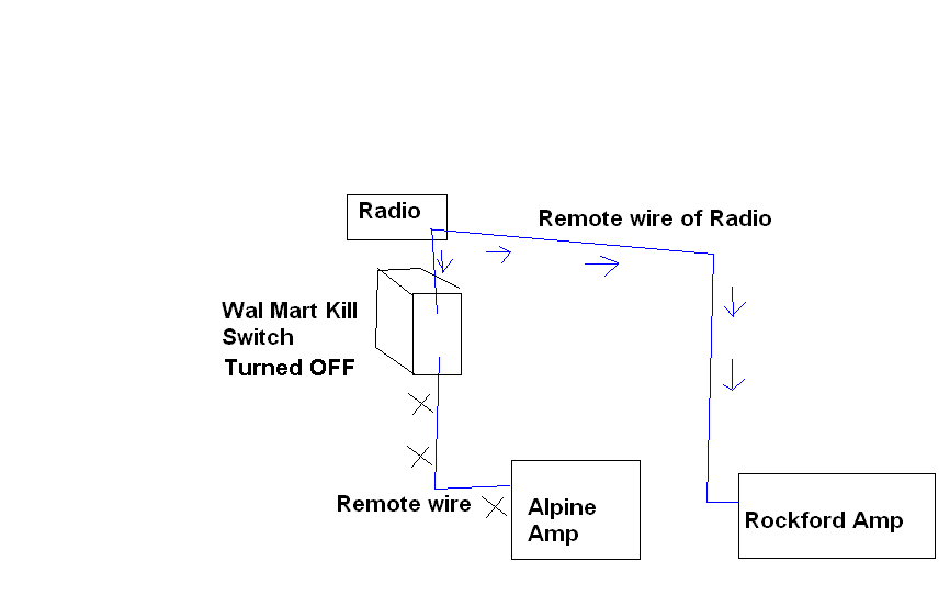

Posted By: i am an idiot
Date Posted: July 16, 2009 at 12:23 AM
posted_image

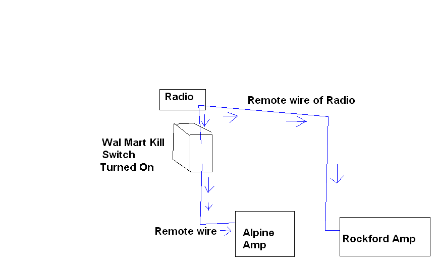

Date Posted: July 16, 2009 at 1:14 AM
posted_image
Posted By: imupabove
Date Posted: July 16, 2009 at 2:17 AM
so when i turn off the kill switch, its going to turn off my MRP amp only right?

that pick is kinda confusing to me :\. but their is way right, to kill ONLY my MRP. i havnt checked it out yet because im still waiting for my gear to come in.
