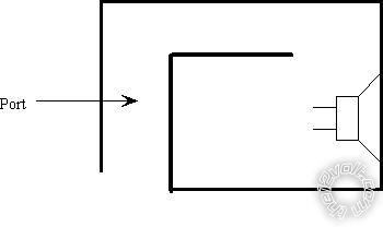

xchrisx wrote:
How would I make the L type port??? and also whats an advantage to it?
An L-shaped port is simply a slot port that follows the inside walls of the enclosure in an "L" shape.  The advantage is it allows a longer port than just running straight into the enclosure (if you need that for your desired tuning.)
Something like this:

thanks. also, how would i figure out the measurements to make one? like how they have a recommended port size, how would i convert it into the L Port for proper tuning?
BP
Posted By: DYohn
Date Posted: December 11, 2009 at 1:25 PM
There is nothing different in these from the way any other slot port is calculated.  You simply make it the size and length you need, measuring the length from the center of the opening along the path the port takes to the center of the exit.  It can have 50 bends in it if that's what's required to get the length you need.
