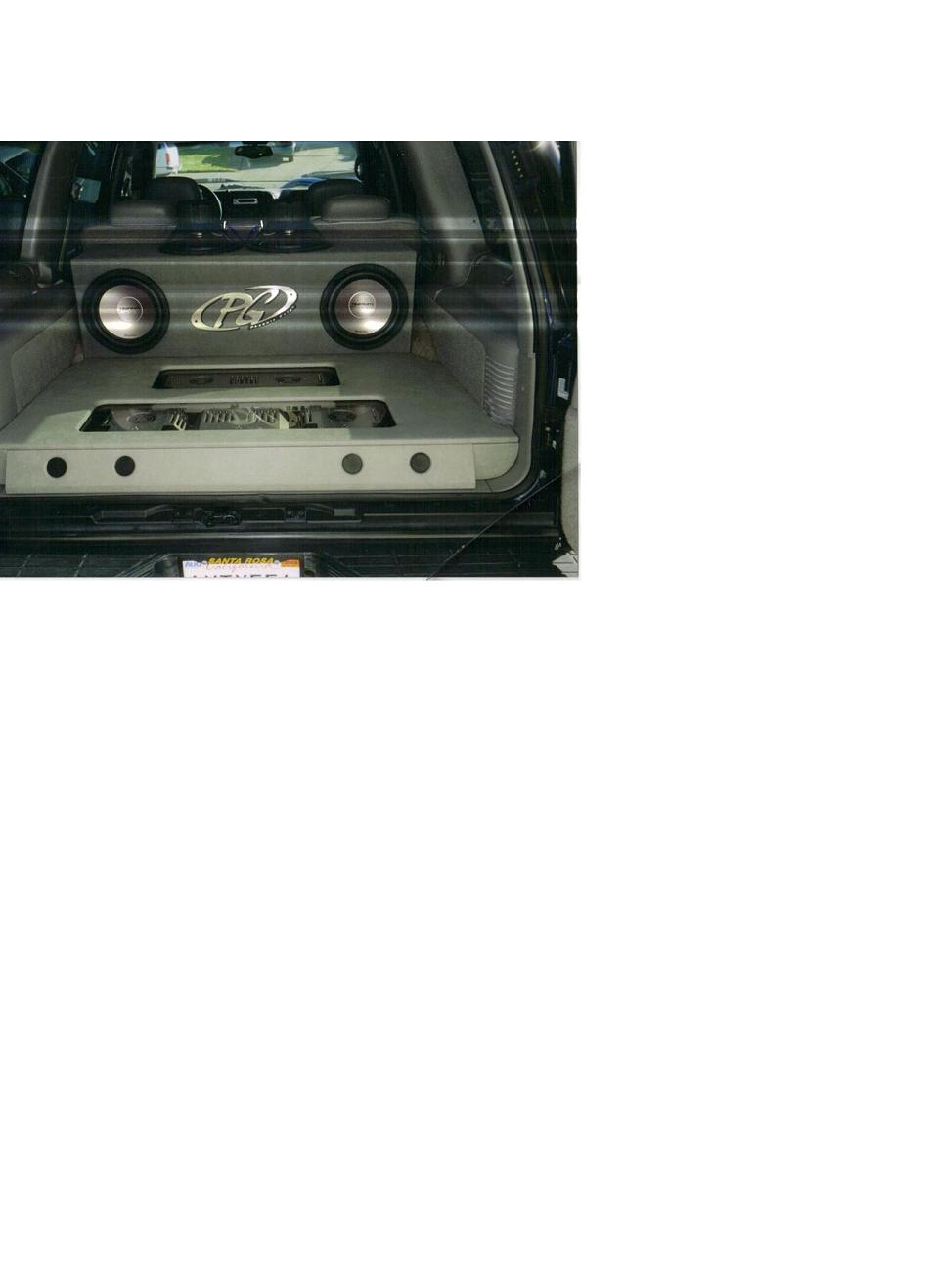

Posted By: ianarian
Date Posted: August 11, 2009 at 12:16 AM
Bad pic, but here is a Yukon we did with the raised floor and 4-12's. 1000 watt and 2-200w and a 12 farad electronic cap and a Phoenix Gold line driver under the seat. The raised floor had a tunnel system that we had the fans blowing through it, like a maze. Two fans in, two out for proper cooling. The subs we wired 2ohm stereo, push and pull...posted_image
