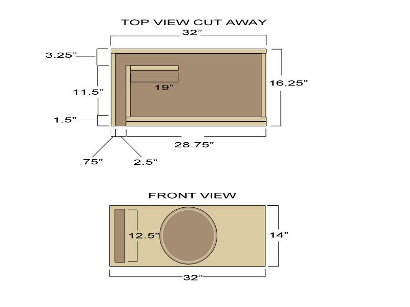

Ok, those dimensions are sweet.  I am figuring the port now but would like to double check my idea with you.  I want the sub centered on the 32" L face with the port at one end of that same face.  The port should then be 2.5" W and should be 13.75" with a 90 degree bend that would then extend another 21.5"  along the 32" face.  Is this correct?
32"L x 16.25"W X 14"H. Port 2.5"W X 12.5"H X 34"L

Date Posted: November 30, 2009 at 10:31 PM
If those dimension I gave will fit. I can sketch it up for you.

Posted By: j.reed
Date Posted: November 30, 2009 at 11:28 PM
Here you go. I would make sure it will fit 100% before having the wood cut. Easier to change dimensions now rather then once it is put together.
RE MX12 Optimal 2.0cu.ft NET Ported Enclosure. 33 Hz
BTW is this not drawn to scale posted_image But the measurements are correct.

Posted By: j.reed
Date Posted: December 01, 2009 at 1:22 PM
I made a small mistake. Caught it this morning after a bit of sleep, that i sent you the wrong Image. The port wall Inside should be longer Instead of 15.75" it should be 19". If you leave it as 15.75" it will make Fb 34.8Hz. Thats a bit too high. I wish I would have caught this last night. Very sorry. I loaded the pic to photobucket and then found the mistake. I fixed it but i sent the wrong image with the shorter port. Here it is correct one. This time i know i got the right one.
RE MX12 Ported 2.0cu.ft. NET. Fb 33Hz
